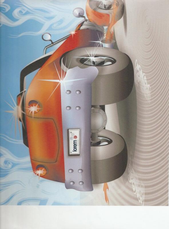

I suggest using Coreldraw, I don't use Corel but do they have any vector sample images you could export as an eps file & print it out as a vector file?
eaddesigns
here is a print from a corel sample file. The horse above is a vector image we designed in illustrator.

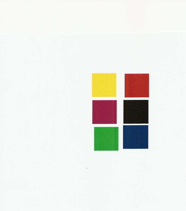

eaddesigns
these were printed on 3651 using roland color palette
GCVP
Standard
convert to spot colors checked in file format
pdf
heat settings 45/50
roland ink
Black and blue look good on this one
wondering if i need to replace the MG/YE head
