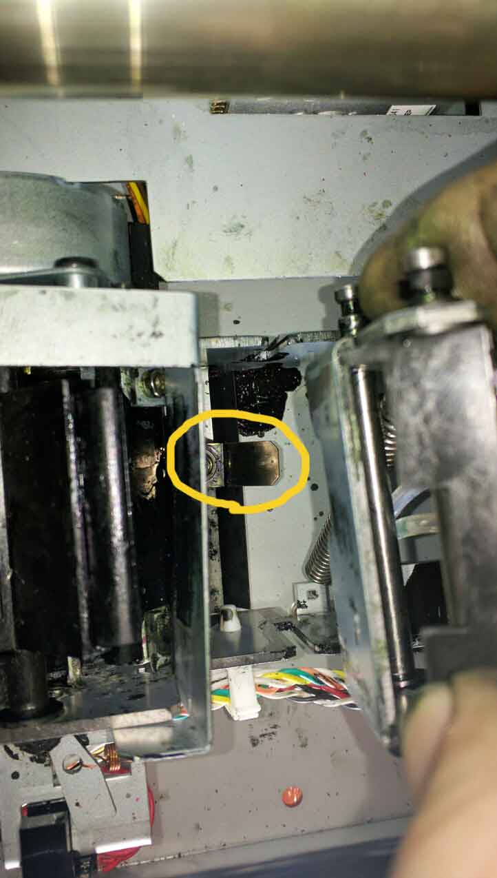

I found out what is was. It has a DX6 head, which is basically the same as a DX7. There is a metal tab that holds the bottom metal shafts on the capping station. One of the shafts popped out and it was over the metal tab when it should be under the tab.
HellCat
I found out what is was. It has a DX6 head, which is basically the same as a DX7. There is a metal tab that holds the bottom metal shafts on the capping station. One of the shafts popped out and it was over the metal tab when it should be under the tab. View attachment 133266
I have the same problem, how do you get that shaft back under the metal tab? I'm afraid to break something.
