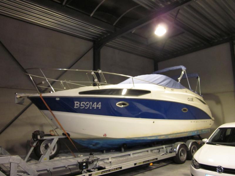

We've been asked to redo the blue stripe on this boat in matte black.
I have done a few custom boat names in cast vinyl (hexis or Avery) and they seem to hold fine, but what about doing a whole side of a boat with it?
Could we use the same cast vinyl like avery 900, and would that stay on?
What lamination should we use (scratches etc...) I have thought about the convex stuff, but our local supplier doesn't have matte convex lamination.
I hope the boatwrap guys can point me in the right direction...

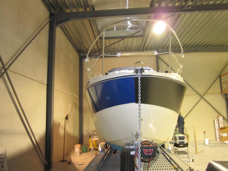

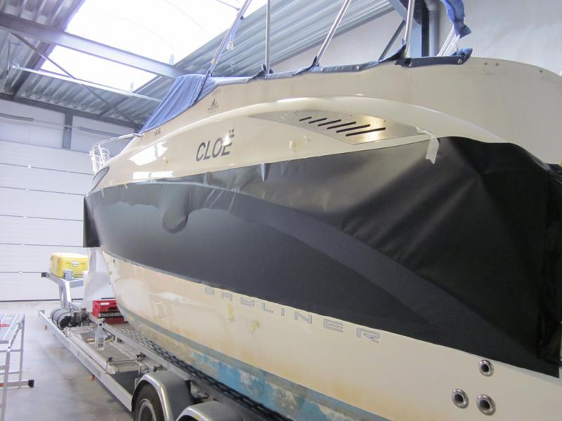

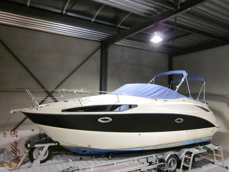

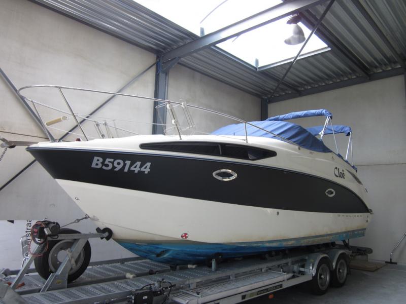

We did get to finish the boat last week, result looks very nice, happy customer :)
I did a matte cast laminate on Hexis Cast glossy black vinyl to add extra thickness so there would be less damage in case of collision... result is nice matte finish
here are some pics.
