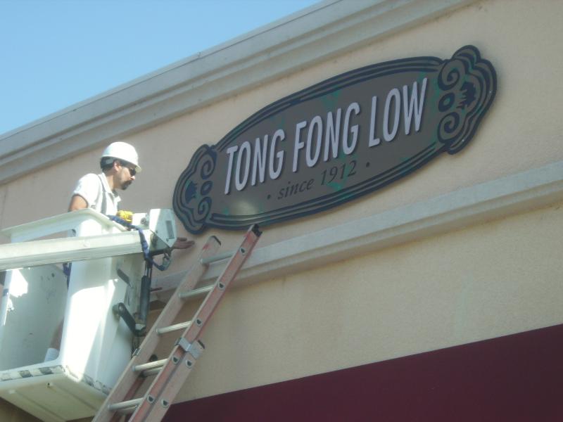

    mactac IB2107 laminating sheets
    the TONG FONG LOW lettering is 100% copper on black pvc polished then router cut

    Sweet - thanks...I will take a look at getting that or similar. No problems with the mist coolant required for the copper cutting acting to break down the adhesive - or did you assemble the two materials after routing?
  6. J Hill Designs
    15,549
    16
    Sep 24, 2004
    assembled prior to routing. no need for coolant IMO
