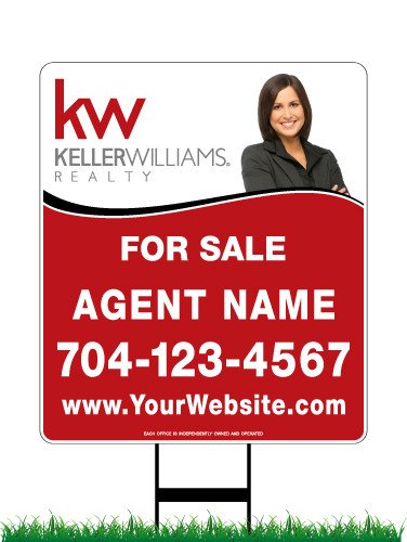

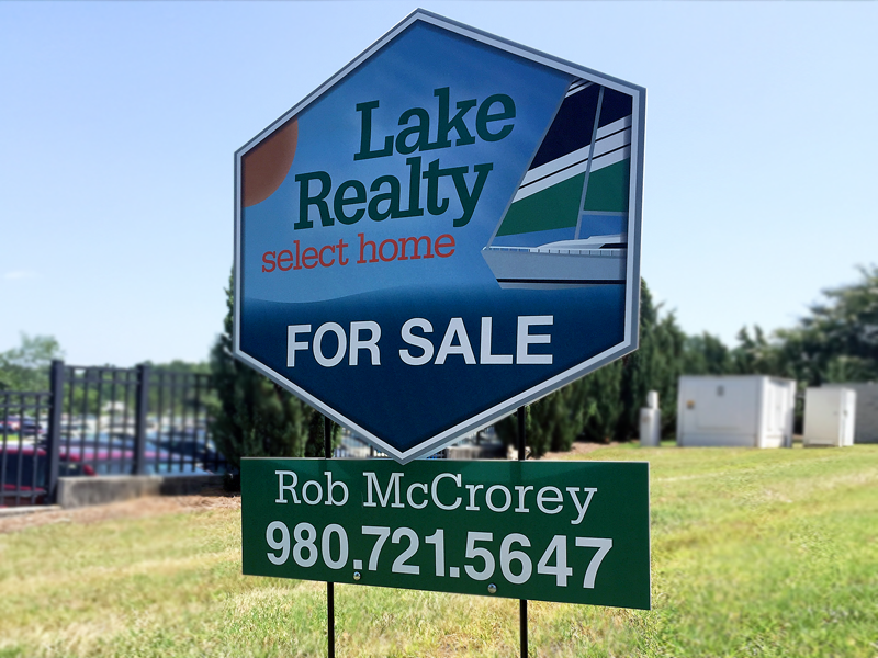

Hi
We are looking for any suggestions for bonding adhesives that work well with polystyrene. We are printing realtor signs (flatbed) on .040 polystyrene single sided and then looking to bond two pieces roughly 24" x 28" togeather on the sides and top so it will slide over custom made sign stakes.
We have tried this before and the edges rippled and almost melted the material.
We have seen several of these signs around town but not sure what glue they are using to bond these sheets togeather.
Thanks!

Try Weld-On 1802 glue for stryene to styrene, bannertape would be less messy but do not know how it would hold up with stryene

Seems to me the failure rate will be quite high on these, what is the customer's life expectancy on these? I would not think banner tape would hold up during your hot summers and polystyrene breaks down quickly in the sun. Can these be held together with a snap on edge guard in conjunction with an adhesive?

Is there a reason for doing single sided and not double sided? if you need a ridged substrate use 1/8th ACM or .090 styrene. Like Tammie mentioned you are exposing yourself for failures trying to glue or tape the panels.

He is trying to copy what someone else has, it might not be that material, styrene, because it does turn yellow and detiorates quickly.

very very true. It seems to be a new trend that agents are using in this area which defies "Realtor logic" as the cost is more than double that of coro.

henryz needs to be two single sided sheets to create a pocket so it can slide over top of the custom made sign stakes.

Because coro looks like crap and higher end realtors are trying to sell an image...and selling that image works. Plus a single sided sign with a wire stake is the preeminent hack job in the sign industry. Cheap isn't always the right answer.
MEK brushed down the edges and quickly covered with the second sheet will melt/bond the two sheets together to the point they will never come apart. ABS adhesive (from any hardware store) is used for ABS plumbing pipe but works great on styrene. The ABS adhesive takes a minute to set up so it gives you a little time to make sure your panels are aligned.

Thanks Pat! Exactly what I was looking for.
