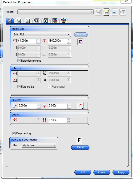

Hi BIG EASY DOES IT,
Did you selected the borderless option from the SAi RIP menu? if not, g
o to the Default Job Properties and inside the Format tap, select the “Borderless Printing” check box.
attachment.php
Please let me know if this fixes the problem.
Yes I have that selected. But all that does is take away the margins. I want to print past the edge. It won't let you start your artwork outside the media edge.
