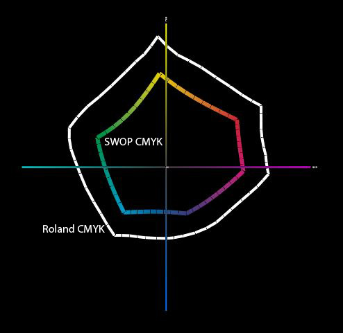

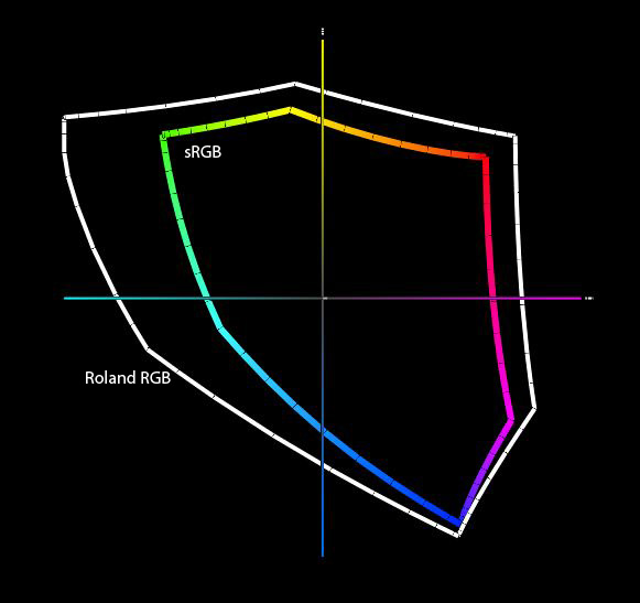

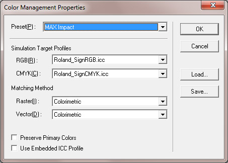

MAX Impact is a very useful preset in Versaworks, though most users have little idea what it really does.
Roland has created its own RGB and CMYK working spaces and using this preset automatically converts the color values in the file to these color spaces. As they are larger than standard working spaces, such as sRGB and SWOP, this causes colors in the file to become more saturated. This preset also disables any embedded working space in the file, and forces both RGB and CMYK-based colors into the Roland color spaces.
It also uses Relative Colorimetric rendering (matching method) for both raster and vector art.
