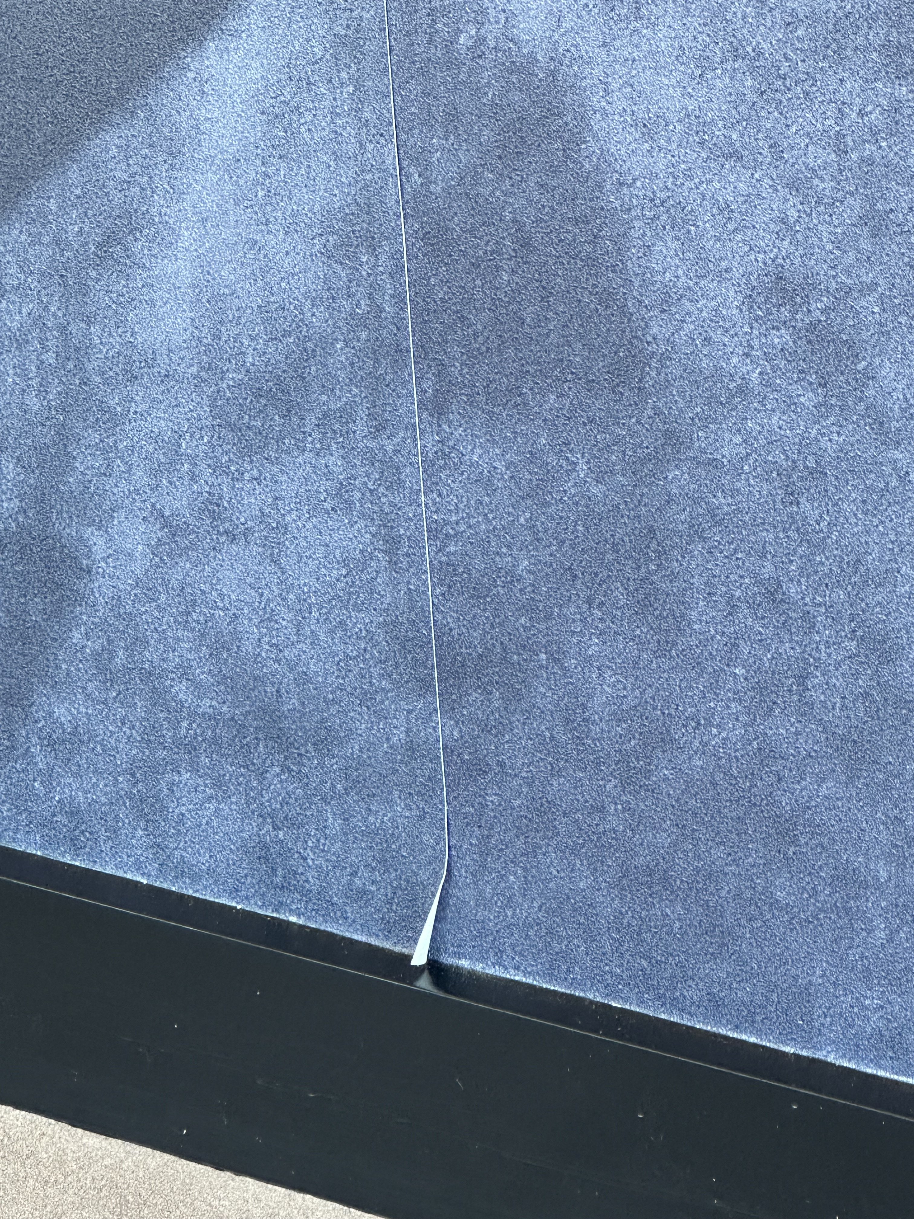

We've just started using this Briteline Multigrip for wall murals recently and until now haven't had any issues. Our latest job has started to lift only a few days after install. It appears to be lifting at an overlap seam. Upon further inspection both overlaps seams (its a 3 panel mural) are starting to lift. Worth noting that the left and right ends of the graphic, along with top and bottom do not seem to be lifting. Only where the material overlaps appears to be an issue. Anyone have any advise on how to fix/avoid this issue going forward?

Laminated? Inkset used?
The fact that it's only having issues sticking to itself tells me something's up with either the laminate or ink.

We have used this material, mainly as distancing floor graphics in the past, I would think because the textured "grip" on the surface is possibly what could be causing the material not being able to stick to itself. Yet, if you have had success in the past....not quite sure. Is a butt seam an option? May cause a slight gap from shrinking over time, but could be better than full lifting at the overlaps. If a possibility, there is a chance you could take a straight edge on site, carefully cut through both layers in between overlap, peel upper layer away, and untuck/pull beneath layer out and reset.

No lamination as it is a textured wall product. Printed with Eco Sol inks. This is the first time we used overlapping seams. I wonder if it's just not great at sticking to itself. We used some 3M edge seal for now to fix the immediate issues. Probably going to try the butt seam, cutting through both layers that Dluckz suggested if it continues to be an issue.
