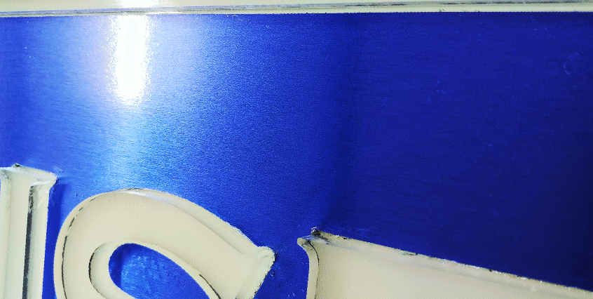

Disregard the gunk, I'm still cleaning it up, this is a push through where, before I routed
the brushed max-metal, I covered it with printed and laminated clear vinyl. I am very pleased
with the outcome...you can't tell from the picture, but while it does cut down on the graining some, when
you walk pass it has an iridescent shimmer.
It's a really easy material to work with. You can even fold it in boxes using v-groove routing!

Andy D
Yep, that's what I did, I had to do a bunch of tests on scrap to get it right, but it came out nice. once I get it done and installed I will post picks.
