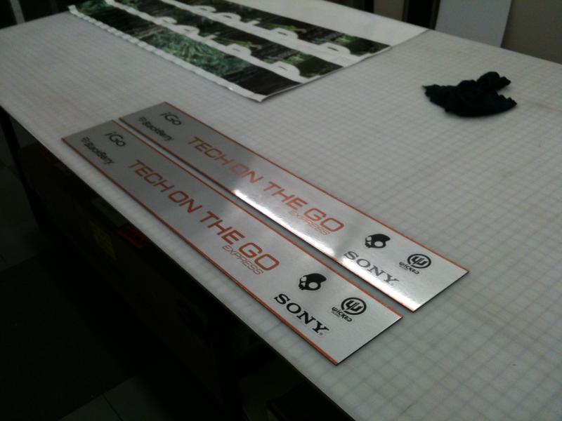

Anicom
It is printable, I've printed on both the outdoor and the inexpensive indoor products. The only issues we've had are that you cannot have print on the edge or it will lift(we've used clear vinyl tapeto get around this in some instances) and I have used it with an Epson GS6000 that doesn't put down opaque ink so that any light colours will let the brushed silver look come through. I don't know about contours as we've only ever put these on Sintra panels.
Anicom
Thanks, no laminate as they are solvent print and are up high so noone can touch them. You'll notice them in dozens of airports around North America in Hudson News locations, sent out about 230 panels late last year...have held up great since then.
The brushed look through the orange is very cool and the black is nearly 100% opaque. The other issue with this stuff is that it is quite delicate, one step away from being tinfoil. I lay down the one-offs by hand very carefully but if I have a big run I laminate this stuff on and it usually works like a charm.
