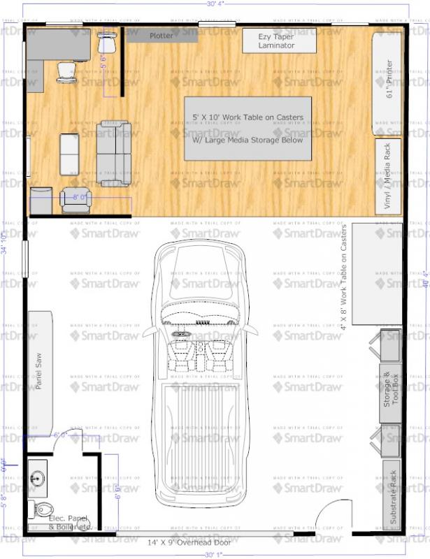

After some obsessive thinking and evaluating, I decided to build bigger.
I'm going with a 30 X 40 instead of the 28 X 34. Still using a 10' ceiling, but going with a 14' door and a wider man door.
Also putting a washroom in, and putting in a "lounge area" that can easily be changed to another office if I expand to another employee, or more equipment.
The walls around the desk area will only be 4' or so high, more of a divider, and the pine laminate flooring will be raised on 2X4s and 5/8 plywood decking.
The panel saw will be an acm cutter or blade. No dusty saw cuts in my shop. And If I need to I will do it outside.
Although a vehicle won't be in the shop most of the time, I could squeeze two in if I absoloutley had to.

Your garage diagram looks like it's only housing a small car or suv..... just a thought say you get a.........
contractor with a crew cab vehicle with a long bed? (3/4tons and 1tons) are about 22' long. Then you have the hitch and trucks with brush guards making them longer nose to tail. 14" is great for the door, especially if your pulling in a dually with elephant ear mirrors, but if you only have 24' in that garage, your going to be touching something trying to close the door when it's cold if you have something that size in there.
then there are cargo vans with extended wheelbases... You probably want to fit that in also.
and say maybe a boat?
I think you may want to go a tad longer so you can walk comfortably around those types.... just a suggestion.

10 ft ceiling and a 14 ft tall door? hummmmmmmm my 12 ft sectional overhead door is on a 14 ft end wall, so there is 2 ft above the door for its hardware when its in the open position.
And how many of those have I done in two years? -None
If I do get one, I'll manage.
I can have it overhang the wood floor if needed.

Just wanted to bring it up cause we goofed when we built ours and now adding on again. Tight squeeze bringing in some vehicles:rolleyes:
