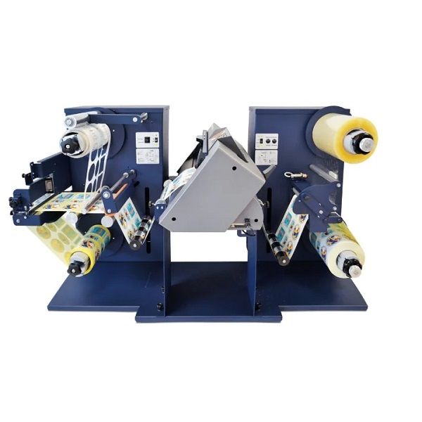

Something on the cheaper side could be for example the Afinia L801 combined with DPR Finisher.
Probably not used by the "bigger companies" but anyways...

That's going into roll label. That a whole different list of low end to high end. The output is similar to a die cut sticker, but not the same.

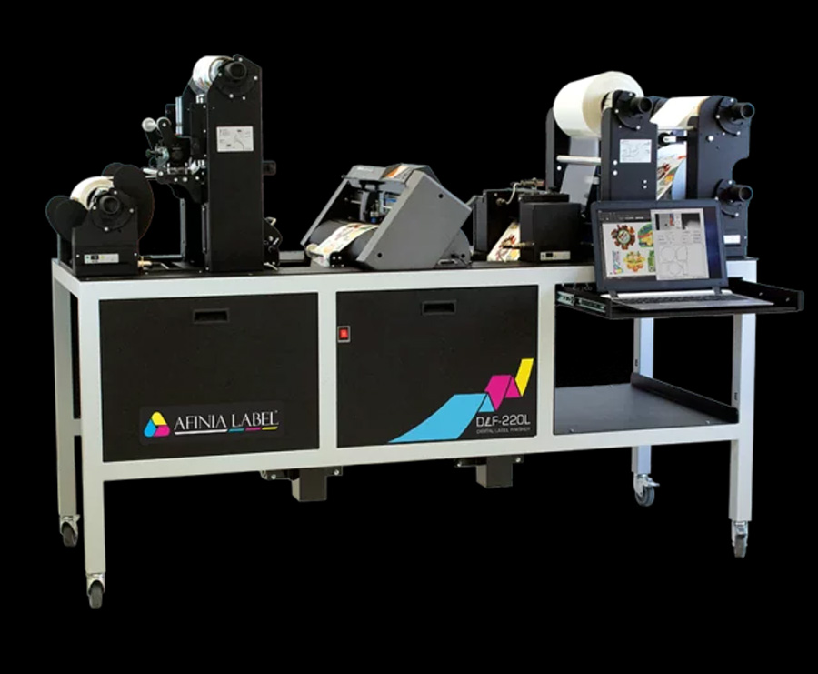

If anybody is interested, I have an Afinia DLF 220L for sale....I'll list it in the for sale section if I can figure out how that works.
