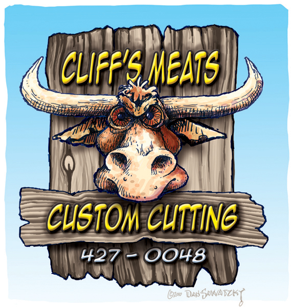

The initial design concept took about an hour to do from sketch to finish. The sketch was in my sketchbook which I then imported into PhotoShop and finished with a digital pen on my Wacom tablet.
The file took me less than an hour to design and send to the router. The head of the bull was created as a simple cutout of Precision Board...

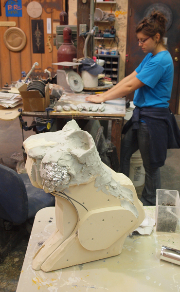

Then I started adding the sculpt filling the larger areas with crumpled up heavy duty tinfoil. This was a money/time saving strategy. In the last picture you can see the pPrecision BOard cutouts as well as the crumpled tinfoil. This is a rough sculpt to get the basic shape. A final layer would be done over this.

Now that I've seen the drawing, I remember another thread of yours, believe it was about showroom improvements/showing someone something to speed up the "what do you want?" process which it was on and didn't put two and two together!

The flat board of the sign is double sided and was routed in two pieces, then laminated together (back to back) with a steel frame in the middle. Before I laminated the two halves together I fastened the bull's heads to each piece. The heads had a core of Precision Board over which I sculpted the bull. The heads were glued to the face and also screwed from the back with some monster screws.
The sculpting epoxy does stick well to the Precision Board.
