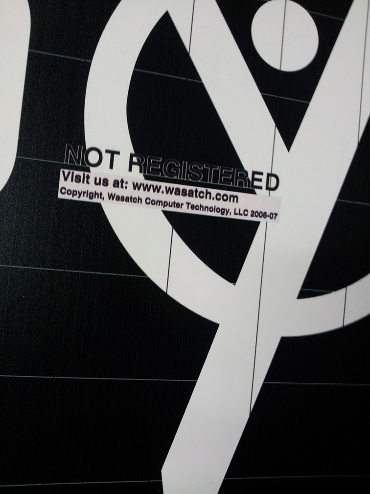

On our flatbed, we use Wasatch and just the other day, printed out a sign and it had black and white lines going through it. Right in the middle it printed a message which was NOT part of the file. Told us our software was illegal. Had it since 2009 fair & square. Wasn't sure what to do, so I turned everything off, left it off for about 5 minutes, rebooted and the next job, it did not appear again. Have no idea why it decided to pout that message right dead smack in the middle of a job, but at least it was a cheap one.
