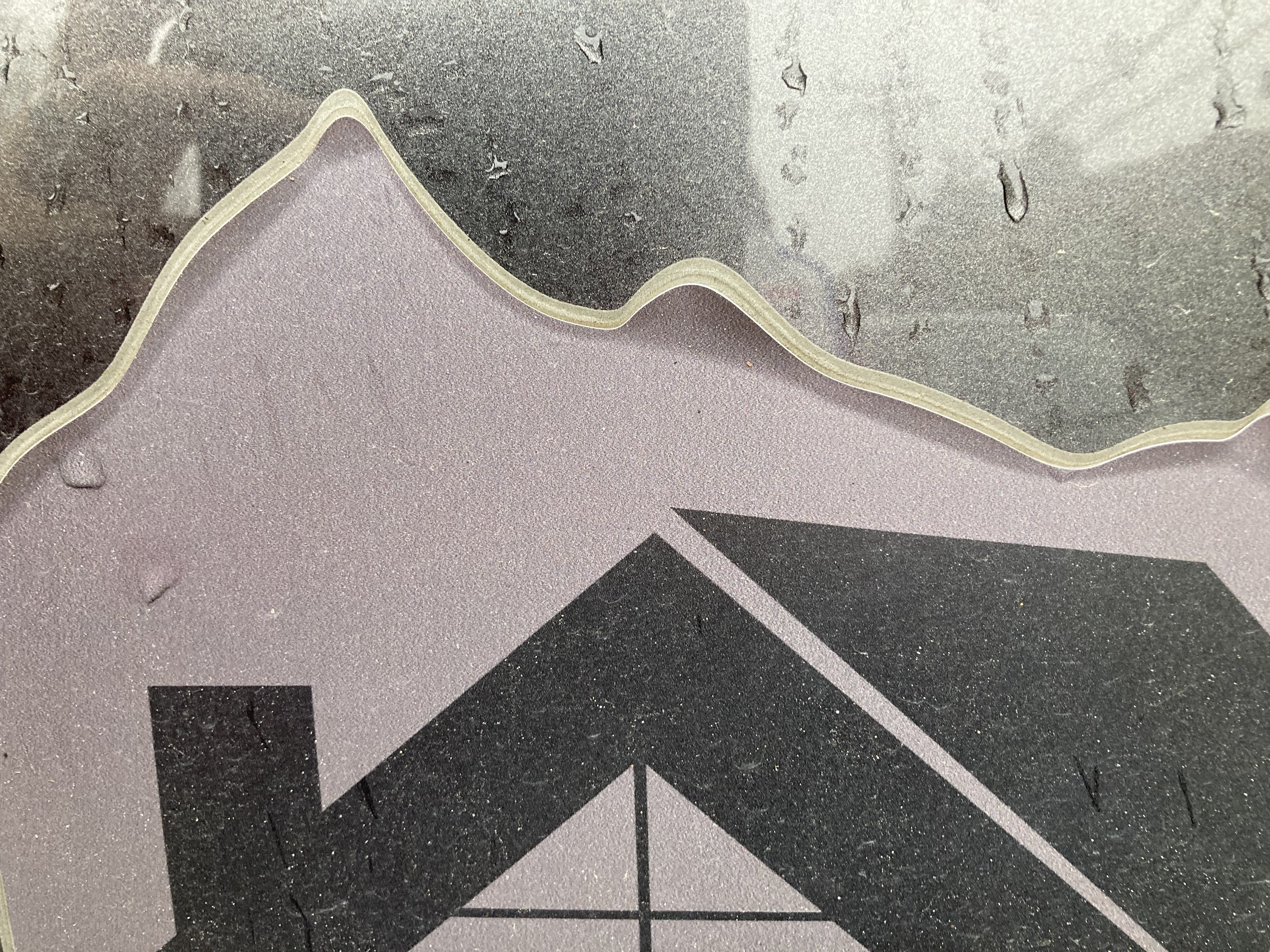

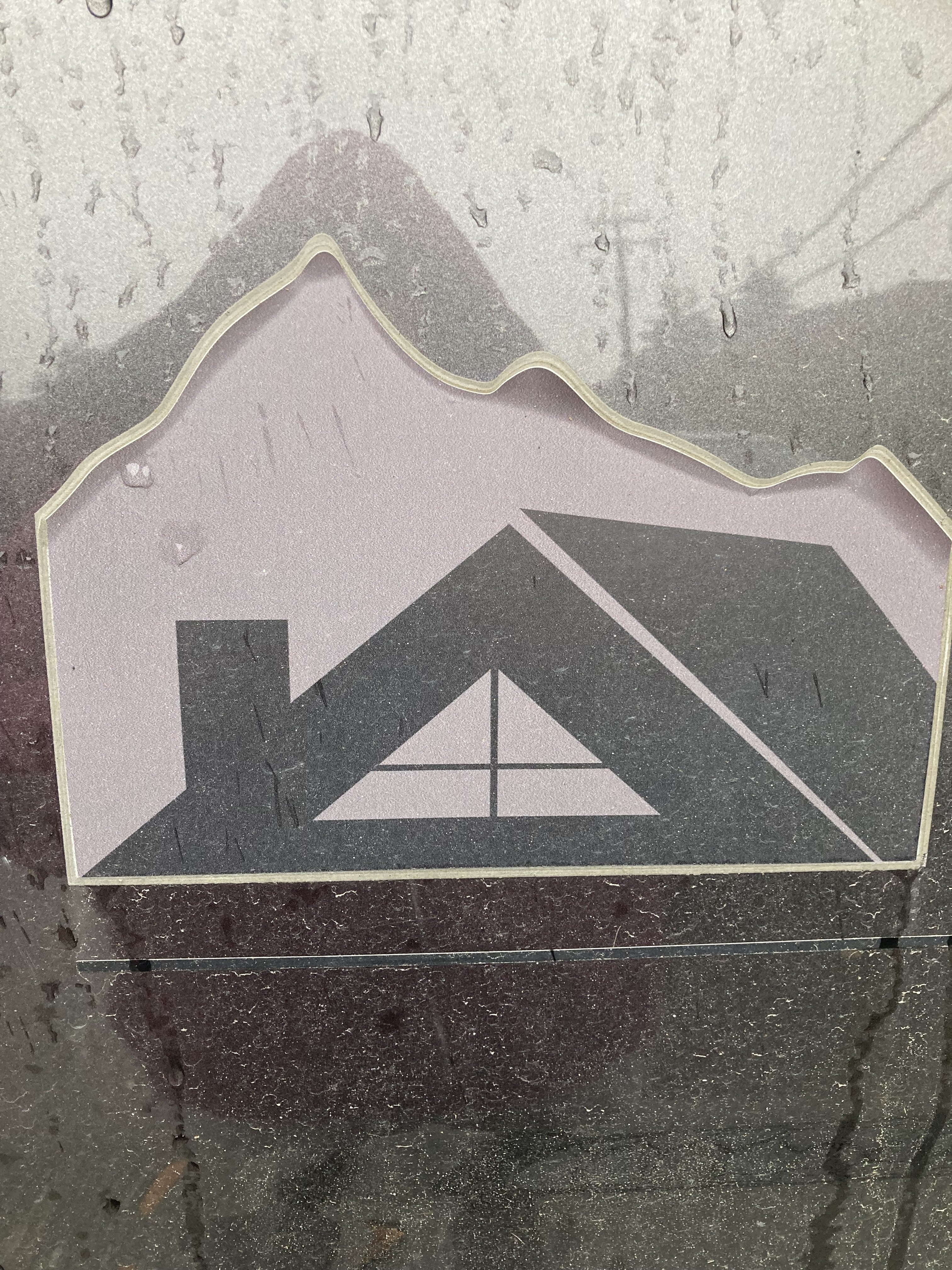

First, using calendared media instead of cast means that you get to save, quite literally, a few cents. Not worth it. Then, after looking at your photo, I've never before seen properly installed laminate lift off the media like this. This would lead one to believe that it wasn't properly installed. I assume that this is just a crappy photo and the gray is really unprinted white and not a full bleed. If the latter then that has a host of problems as well. As for cutting the laminate larger than the decal, it requires two passes through your plotter as well as two weeding sessions and makes for an interesting, to say the least, job. Moreover, why do you expect the laminate to be any sturier than the media?
We cleaned the vehicles thoroughly with an alcohol mix and they were installed in a heated garage that was above 10 C, as recommended. We always allow our prints to degas a minimum or 24 hours before laminating too. I have never had this happen in the 10+ years we've been doing this, so I was shocked when they brought it to my attention. I went and saw them on Friday and took a better picture. Thankfully it's just a few small pieces that need to be replaced on each vehicle, but it never feels good to find out something you've done didn't hold up, as reputation is so important and no one wants to have this happen. We always strive to use the correct materials for the job, but as we've had great success with doing print, cut and lam decals using the Hexis medium, we thought we'd be okay to use it on this project as well. I guess this was the job that was going to bite us in the butt is all... lesson learned!

The shrinkage in your picture doesn't look normal, not even for a calendared vinyl, and certainly not for a rather small sticker on an almost flat surface.
How do you apply the laminate?
Is it possible that you stretch the laminate when you apply it, and that it simply shrinks back to "normal" again?
We allow the print to degas for a minimum of 24 hours and then apply the over lam with rollers (we have a Royal Sovereign wide format cold laminator). Area was thoroughly cleaned with an alcohol mix and installation was done indoors at +10C as recommended.
