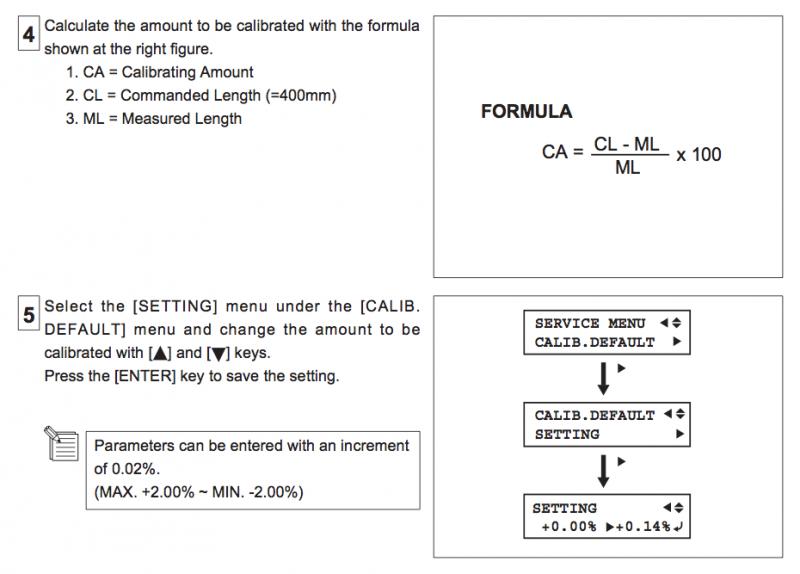

Pretty scared of these two steps tho (see image)...
Robert M
pet g
Yes, use a high gloss film and don't lay down a lot of ink. You are looking for a good clear clean image, use a loop to make the adjustments.
