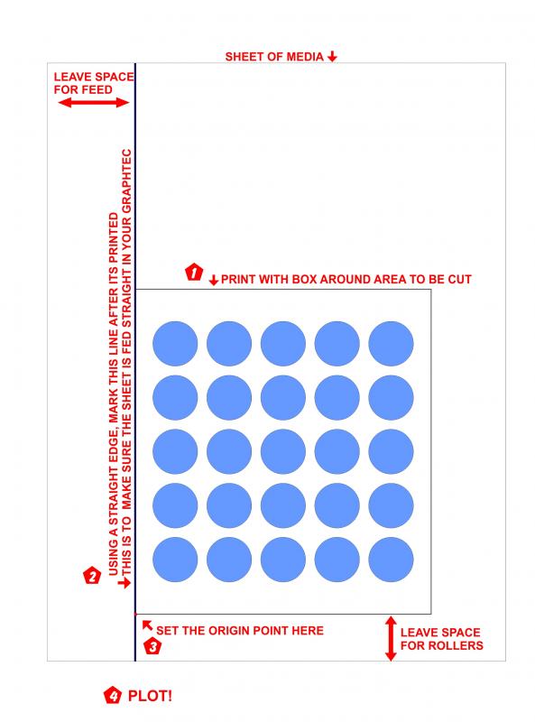

Yes, absolutely you can. Its hard to explain, so I drew a quick diagram...
