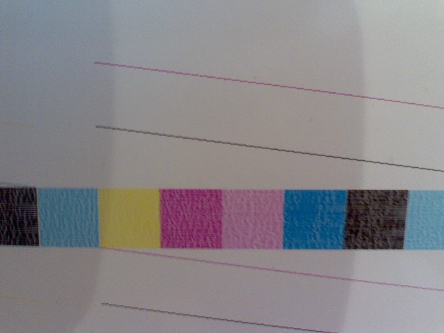

Here is a few pictures of what I want to check into.
The first pic is of a tes print, the colors are kind of spotty.

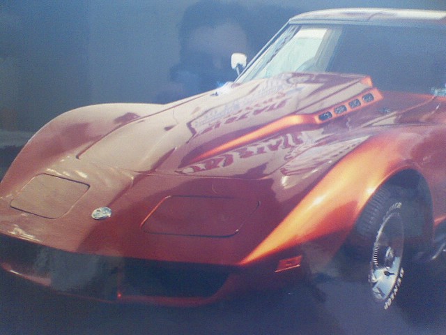

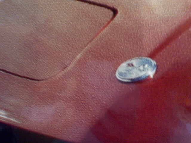

The second pic is of a job that I am printing for a customer. The darker parts of the car body look good but the highlight areas (pic 3) look kind of blotchy.
Anyone have any suggestions of how I can make this better or is this normal?

To me your nozzle check looks normal. My Falcon Jr look just like that. The blotchyness your talking about I think might be helped by turning up the rear heater. Try going up 5 degrees and do a sample and se if that helps. You want the heat as high as you can get it with out the vinyl buckling. That will dry the ink quicker and it won't have time to "puddle" up like I think it's doing.
LEt me ask another question, should I be able to feel the heater on the rear? If I put my hand on the front one I can feel the heat but I feel nothing on the back. Maybe something is wrong with the rear heater?
PSG
Yes you should be able to feel the heater in the rear just like in the front.
It works exactly the same way, heats thru directs contact with the vinyl.
You should open it up and check it.
If it is or once you get it working, you should get some of the foil insulating tape from a hardware store and put it on the heater element on the inside. This will help dissipate the heat more evenly and is said to help with the splochyness on prints.

I agree my nozzle check looks the same as your photo. I had a similar problem and adjusted the temperature, but it wasn't until I cleaned the vinyl that I got the results I wanted.

this really looks like a media issue.
cleaning with denatured alcohol should show some improvement
but not really solve the issue.
studio10
I also think it`s a media issue. Bad, dirty or old media. On my old Encad (water based) sometimes prints also look kind blotchy, mostly because of static electricity.
Steve C.
Yep. I had a problem like this with a roll of window perf. Sometimes
you just get a bad roll. Try another media and see what results you
get.
