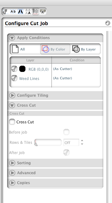

Looks like it's possible in the crosscut settings

I am using cut master 4 and dont see the same options. Only choice I see is for cross cut after plot.

You can download and use cm3. I have both installed , I prefer cm3 because I'm used to it. Not sure if the options there in cm4, but I can check when I get home.
