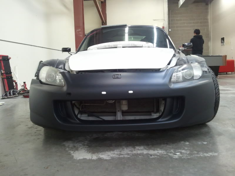

Do you guys think this front bumper could be done in one piece? I am using 3m180 matte white and my concern is that it can't be stretched that much. I would think maybe in pieces? LMK your comments...

most definately!
edited: although you may have to make two 5"x8" tiles for the vertical recessed pieces. won't even see the seam that'll run along the groove
mikey-Oh
Uh maybe, though I'd probably do an inlay on the walls of the deep recess. Most people won't even see the seams. If you attempt one piece, I recommend using the least amount of heat possible and well placed relief cuts
HulkSmash
keep in mind when doing it. Leave about 1 foot of bleed.. because when pushing into the contours it'll take up some footage.. if that makes sense?
jc1cell
Relief cuts :rock-n-roll: + patience :notworthy: + heat to remove wrinkles :peace!:+ patience :notworthy: - heat to stretch :noway: + patience :notworthy: = one piece :thumb:
In my limited experience, heating the vinyl when it starts bunching up (wrinkles) and then letting it cool down helps a lot in getting bumpers done. That specific recess is pretty deep and you may end up re-doing it with a new vinyl panel after you mess up the first one. But it certainly can be done. The above equation is proof of it and math is never wrong :frustrated:
jc
Mikeifg
If that bumper is not painted I would probably say no. Especially when you try to stretch it into the recessed areas. Those bumpers are sometimes too slick nothing for the vinyl to bite like a clearcoat on a paint job.
