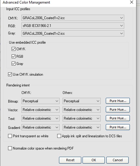

To what are your rendering intents set? What are you inputting, bitmap or vector, CMYK or RGB? If this information is buried somewhere in the myriad of responses, I apologize. Reading all of the coloristas' lengthy responses tries my patience.

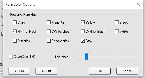

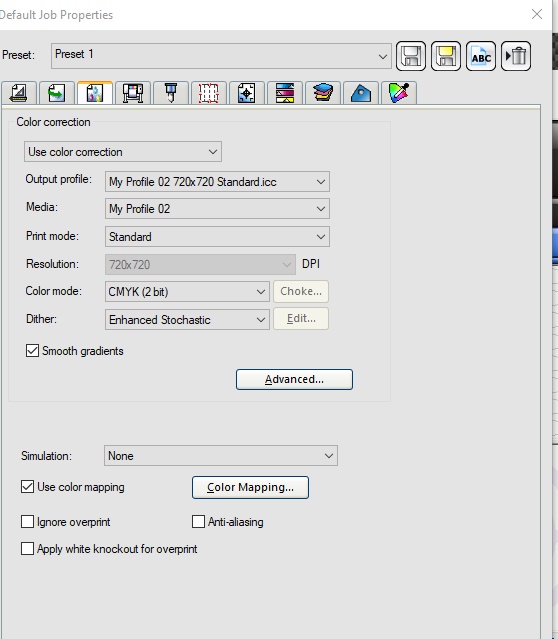

I should note that I am running through Flexi on both machines using their standard Red so comparison is the same. When I couldn't get the colors to print properly I did try running through VW but I always have the similar results so just decided to stick with the Flexi rip since that's what I known for the last 12 years. Attached is what I am currently running that gives me the best results. flexicolorsettings1.jpg flexicolorsettings2.jpg flexicolorsettings3.jpg

I should note that I am running through Flexi on both machines using their standard Red so comparison is the same. When I couldn't get the colors to print properly I did try running through VW but I always have the similar results so just decided to stick with the Flexi rip since that's what I known for the last 12 years. Attached is what I am currently running that gives me the best results. View attachment 151845 View attachment 151846 View attachment 151847
