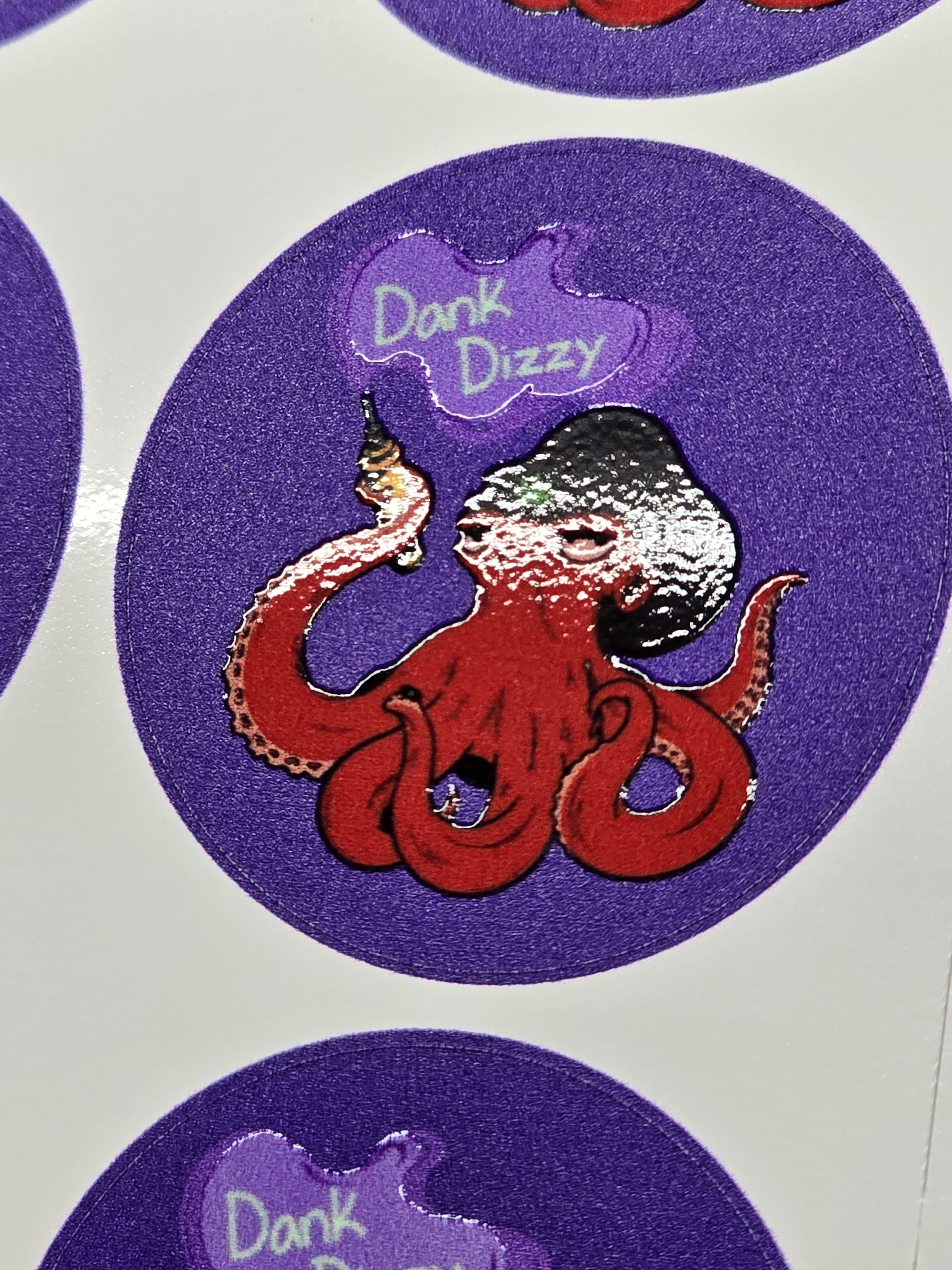

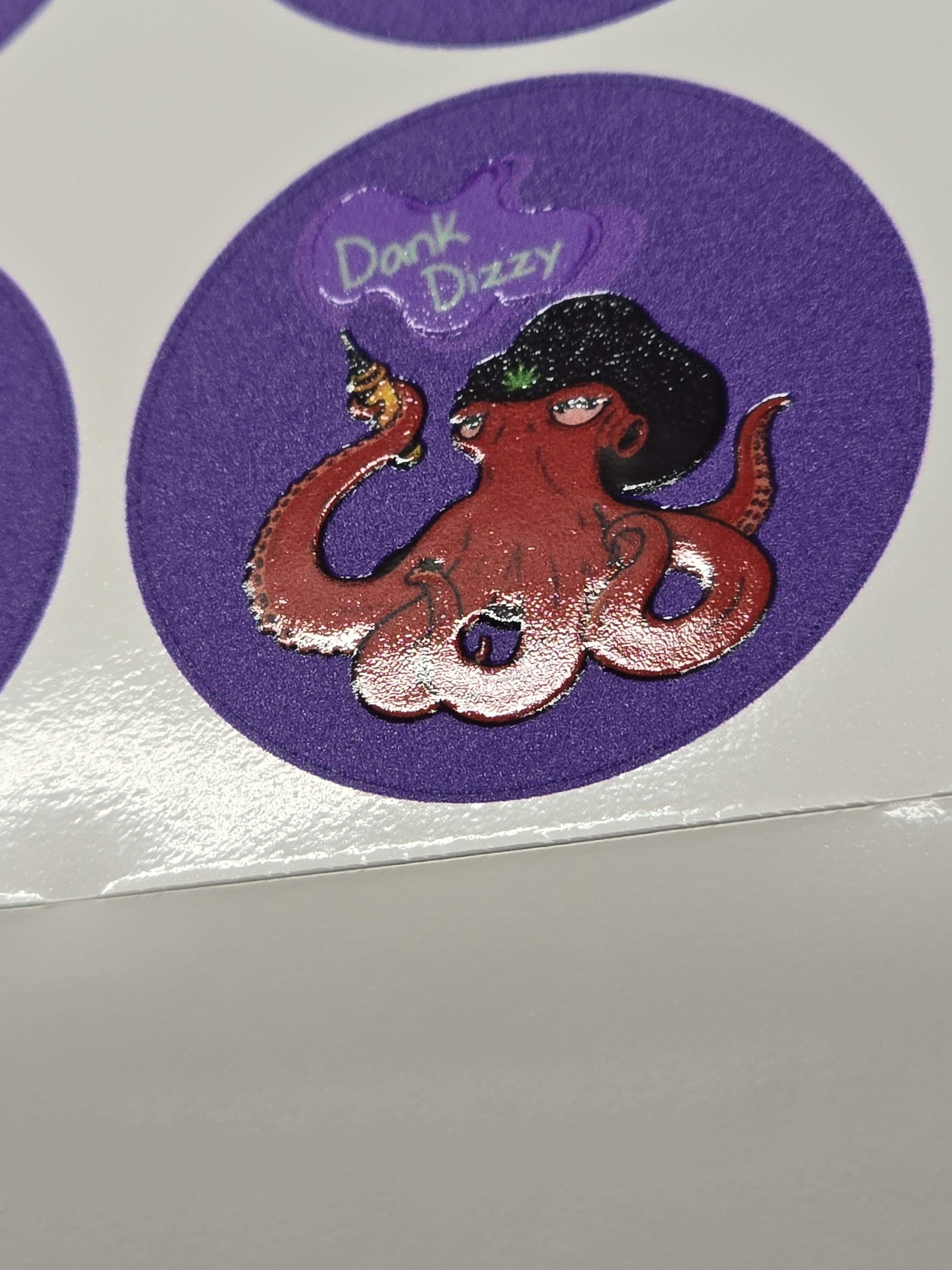

It seems that I can't see a perceptible difference when doing one vs two layers of clear. I'm also noticing only the very beginning of my print it really slops it on there (in a good way) but after the first portion of the print, it has a weird, rougher look to it... Here's an example, first pic smooth second pic rougher. Wondering if there's a way to get a more consistent clear print?
