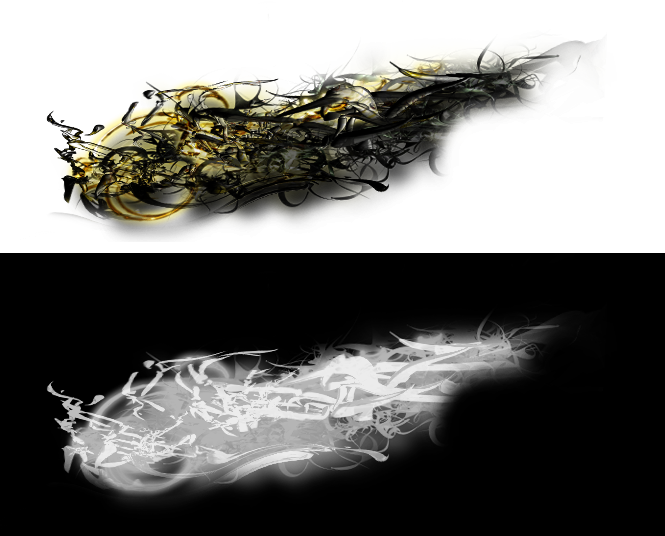

so here is the design with a white trap. Could this be done on clear with a double bump? (Print the white then double bump the white image with the full color image?)
The way I've done the white trap allows a generous cushion for registration inconsistencies up up to a quarter inch without affecting the final image.
