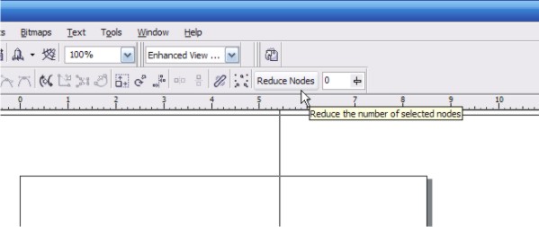

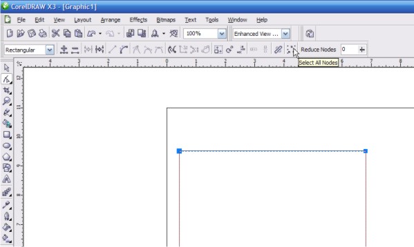

lol this is a good read...but on a bit of a serious note...a lot of fonts out there are recycle bin material when it comes to vinyl production. If I decide I absolutly have to use one I start out with convert to curves and weld...I do this all as one.I simply selct my "live" text and hit weld. I made my weld a quick key just for this. That way I dont have to convert to curves, break apart then unselect my centers then weld to keep all my lil bits. after I weld I select all nodes -convert to cusped curves and then finally reduce all nodes. If your contouring them before hand and your in a version before X3 I kinda feel bad for you...Corel never hit the right arc algorithm til version 13. So ever contour was a collection of segments with out a single curve in there. So repeat the above(select all covert to cusped curves and reduce) X3 users have the new and improved contour that uses arcs and segments. If your contours are wacked then your letters are whacked.

signrik sorry that came across as a bit complicated..in reality its not hard its mostly vocab and knowing where to find what your looking for. The 2 sc's I put with the post are what comes up when the shape tool is being used in X3. The "select all nodes" was absent in a few versions but made a comeback for X3. It can be added back into your toolbar by going to tools>customization>commandbars>edit...its there and you can drag and drop it into your tool bar(to make this easier have your shape tool selected before you head to tools, makes it easier to drop it where you want). Hotkeys are in the same spot..I go to All instead of Edit then select Weld in the list, hit the shortcut keys tab and enter whatever keystrokes you prefer, in my case I use shift+w.
