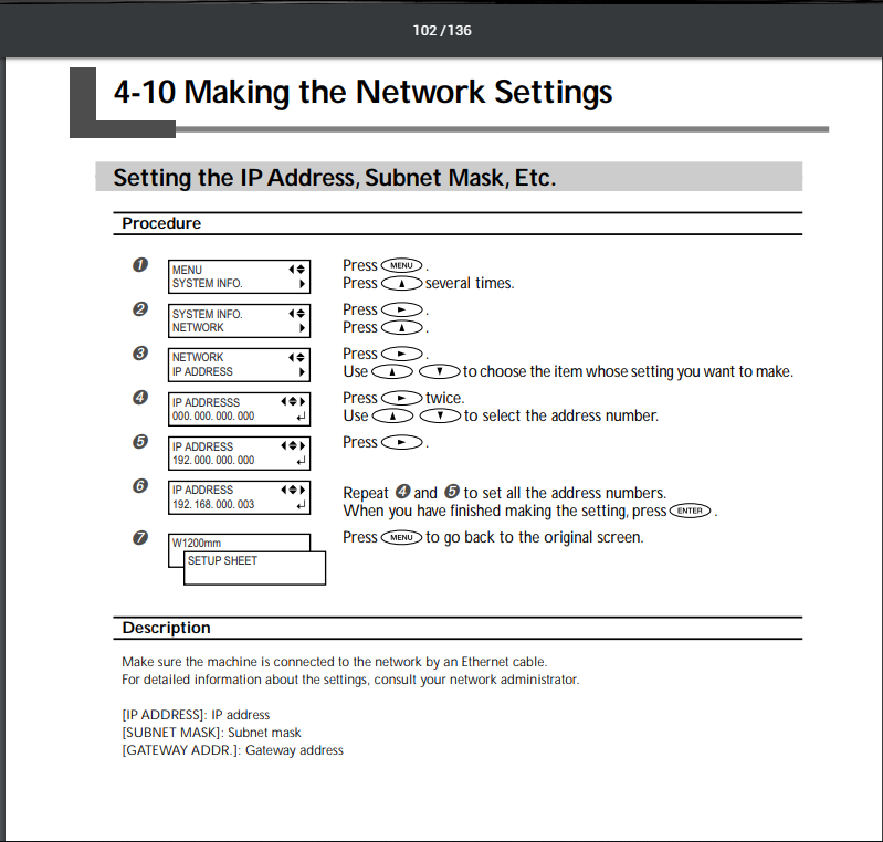

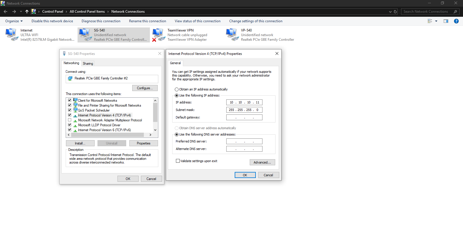

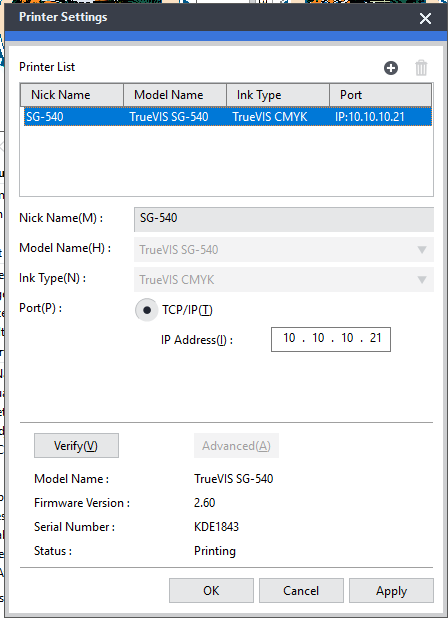

Never used this printer. I am trying to connect to my computer.
I have a old dell running widows XP.
I have Versaworks & Flexi Sign pro.
It was used by the previous owner. He said it worked fine for him.
I cannot find the IP on the printer. And its not connecting automatically. I played with the submask etc. But I am very confused because I am a Mac user. PC is so foreign.
Can anyone give me some advice. All this work to not being able to connect to the computer is a bummer.
I need help.
