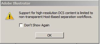

    Got the same error with CS2, opened fine in Apple Preview. I then tried to place the image and I got this error: "Support for high-resolution DCS content is limited to non-transparent Host-Based separation workflows."

    I got the same bad results with Illustrator CS2. I next opened it in Corel X3 successfully although there were editing limitations. I then resaved it as Illustrator AI CS2 and it opened successfully in Illustrator.
    Everything in the artwork is a bitmap with the exception of the line of text at the bottom right.
    Here is the information on EPS DCS from the Illustrator Help Files:
    So, in short, this is a file that can only be printed. Vectors are non existent for most of the artwork. In addition, this is a good example of where the client should provide a JPG proof along with the production file. The reason being that it looks different in Corel X3 than it looks in Illustrator.
    If I were doing this job, I would open it at production size in Photoshop and then set my color mode and profile and save out of Photoshop in my preferred file format for printing.
