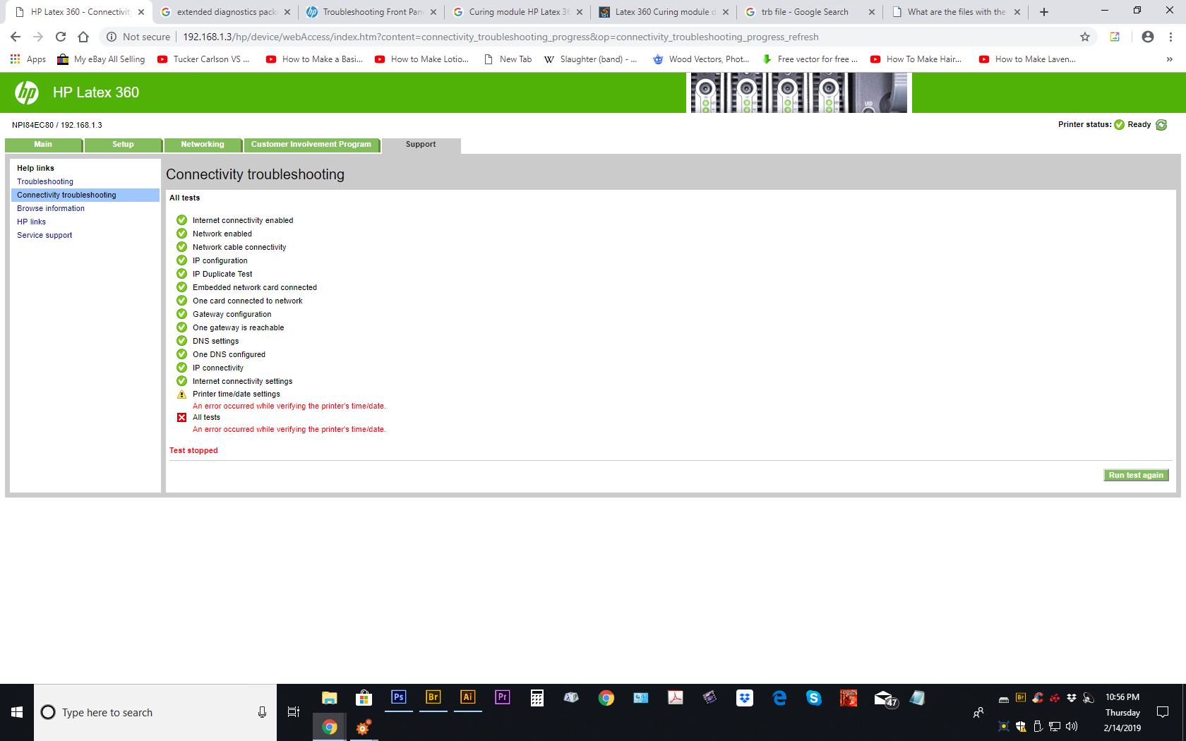

Need Help Can't pass connectivity test. Printer CAN access the internet, but can't verify time/date!
It's so odd. I pass everything in the connectivity test, except verifying the time/date. Any suggestions why?
FYI, I do have a VERY old firmware. Not sure if this is an issue. Don't ask me to update the firmware. I can't jump from a very old firmware to the most current.
Anyway here is a snap shot of my connectivity issue.

Update your firmware... This was fixed in firmware updates.
Sorry that you don't want to change firmware but that was a long-standing issue for some that was patched last year.
It's not that I don't want to update my firmware, I just can't. I keep getting a corrupt error message. I need to update firmware in steps, but the only available Firmware for download is the most current, which is the one that gives me the error message.
