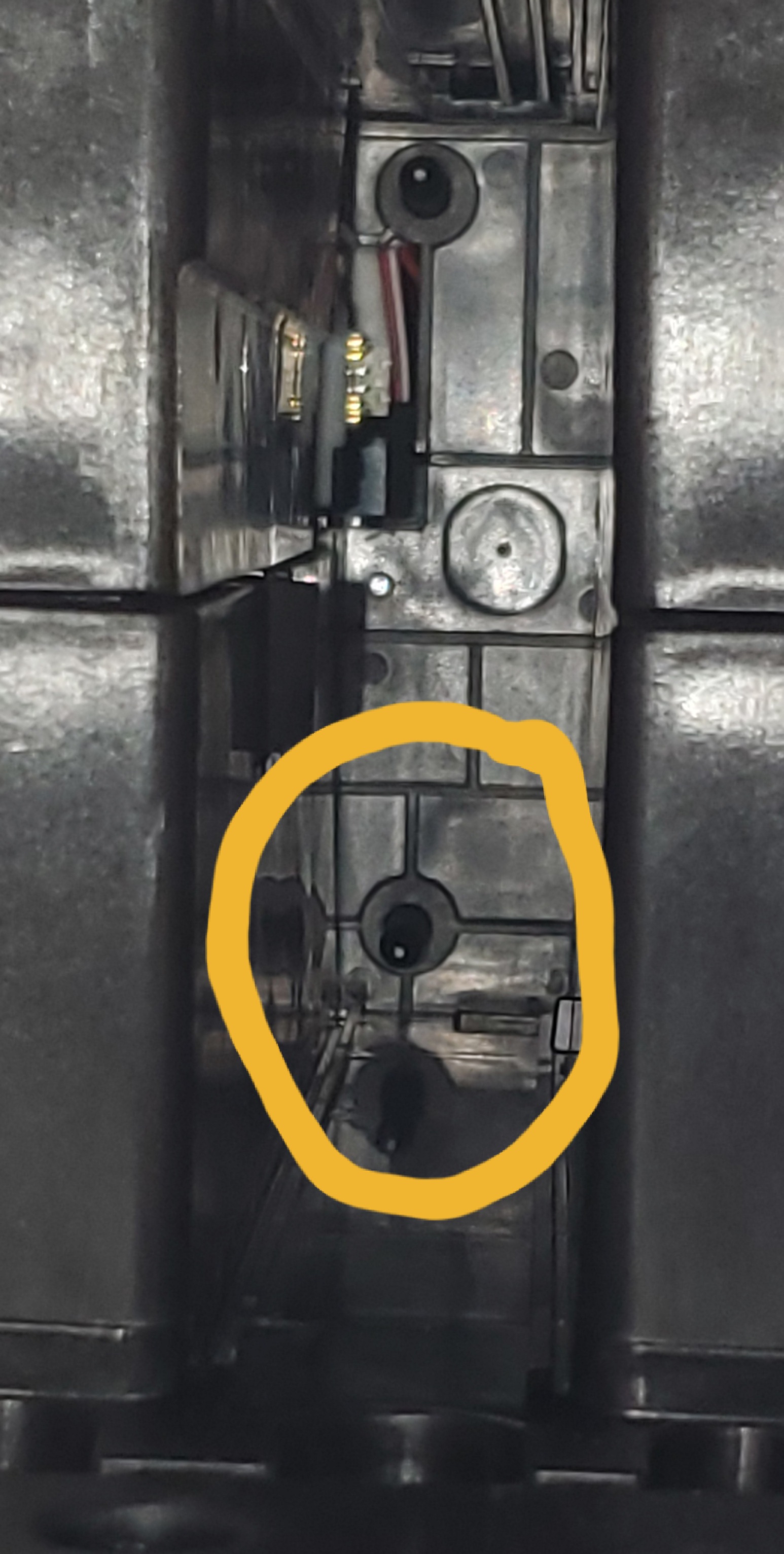

    Or you broke the ink near end sensor. Shine a flash light in the ink bay and see if you broke the flag on the switch lower right side.

    Yes when the tech was setting up my second Mimaki he was giving me extra little tips and one was be careful with inserting the cartridges. This is my LV150-130.
