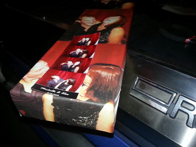

I actually don't put that much pressure on the canvas. I don't farkle around with the tape either, 15 seconds to apply around the edges. I won't be posting a video, but I can saw down a 1x2 to size, nail it, apply tape, and have canvas on in less than 2 minutes.
There is no way you can put out a quality product in 2 minutes for that. Just cutting the wood to length, getting the 45' angle and running them throught the router so the canvas doesn't touch the frame except for the exterior edge of the canvas would take more time than that and if you aren't actually stretching the canvas, it's not going to last anyway. Hope you aren't charging much for that kind of workmanship.

Did you not read how I do it? I don't do it your way. You can see here the end product.
I only give them away, so I don't worry about complaints.

That makes a lot more sense. You made it sound in your original post that you were doing regular canvas wraps with tape. I just did 9 wraps yesterday. 8 of them wer 16x20 but also had to do a 36x92 beast. There is just no way that tape would work on those and they would last for 50 years. I'm with you now. What you are doing is a very nice freebie.
