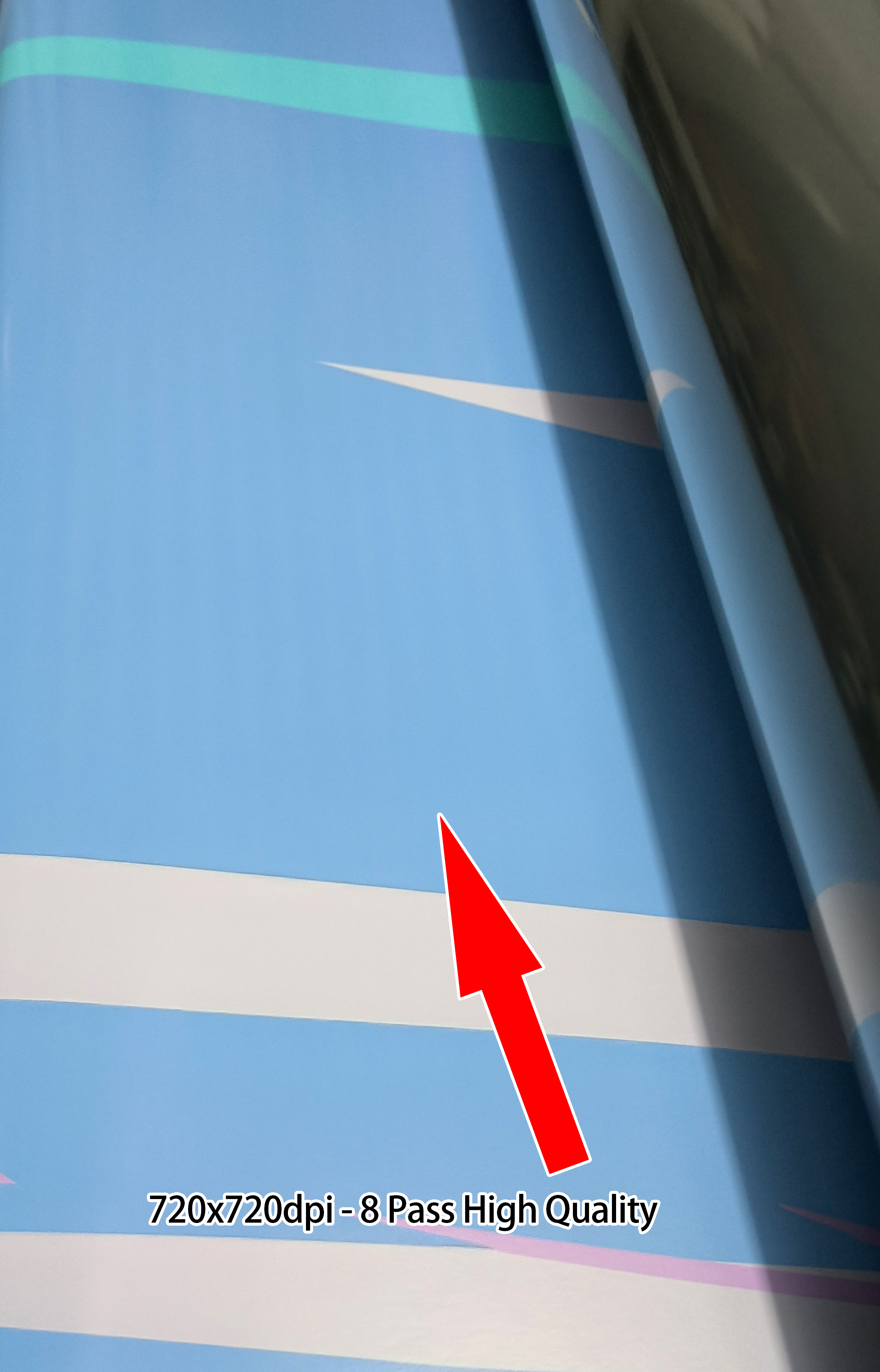

Purchased a 15 day old 80600 and ran into this problem, don't know how to fix it, already calibrated it
This appears to be horizontal banding. If you have already performed the media feed calibration, you will need to significantly slow down the print speed by using a higher pass or printing unidirectional.
Perform a search- many others have reported the same artifact, particularly in blue solids.
swordguy3222
2 things, either run your feed calibration or just run it 8 pass HQ on uni. Solid colour can be a pain, if its large solid colours just run it uni, a little extra time is better then wasted media.
