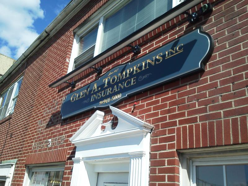

Just finished installing.
Thankfully HTM lighting is back in business and was able to get the fixture from them. Panel is 1.5" HDU carved on shop bot. BenMoore color with 23k austrailian leaf.

Thanks for the compliments. I've been moving away from the goosenecks as I've always hated how bulking looking they are and they tend to always have hotspots under then. I feel like the linnear fixutre gives a much more even light. Also supprisingly a lot of historic districts around here prefer them.
