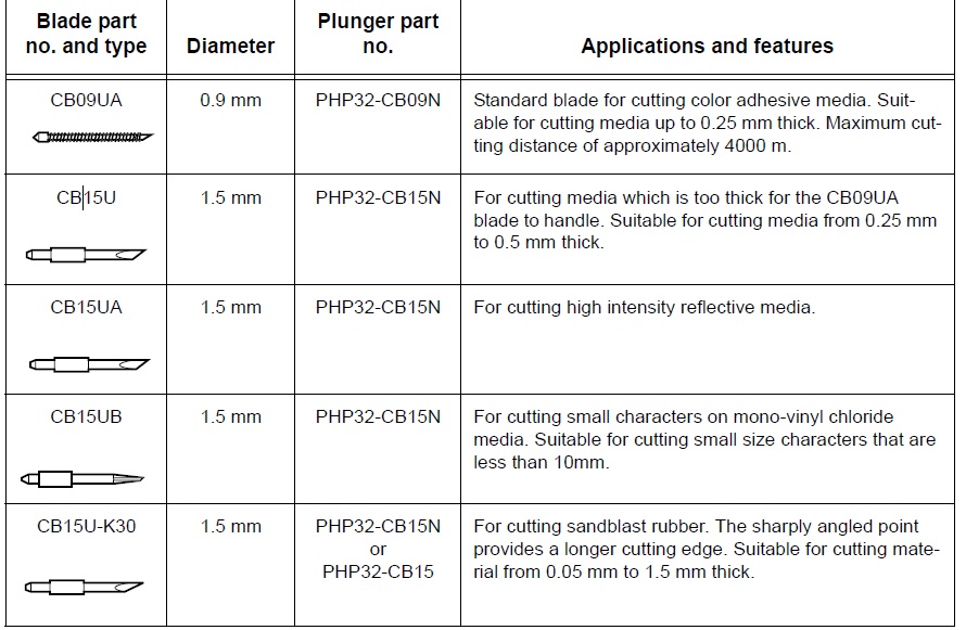

Hi,
Just wondering what blade holder and blade (angle) should we be using for cutting 8 mil (0.2mm) Paint Protection film with some intricate cutting involved?
CB09U (Blue Tip) or CB15U (Red Tip) and which blade (45 degrees or 60 Degrees)?
Thnx
Jburns
Here you go- see attached. I would say CB15U
