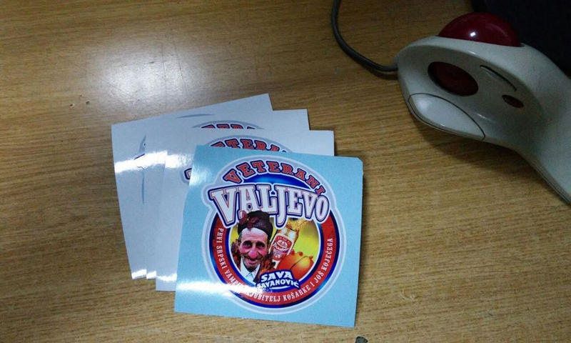

I stayed a bit longer on saturday, printed a bunch of same files with different marks (type 1 and 2), sizes and thickness of the marks, on different materials...
And you know what? I called this morning Summa seller to tell him that i won't be needing him, cause I mastered the art of reading marks on Graphtec. :rock-n-roll:
All day long I been working without a single problem regarding reading marks. I still have to find some time to fine tune Graphtec and to be able to cut thru the centre of the thinnest line possible.
And couple of minutes ago, I just mastered the art of countur (half cut) + perf cut.
attachment.php
yipi ka yei...
In the end, it was the combination of few things... Now, i load the material with the option 2 (only to read the width of the roll), my marks are slightly bigger (but not much, now cca .5") and I leave a bit more space around the pinch rollers.
But, I could not have done it without you Wayne and Denis... Thank you guys...
