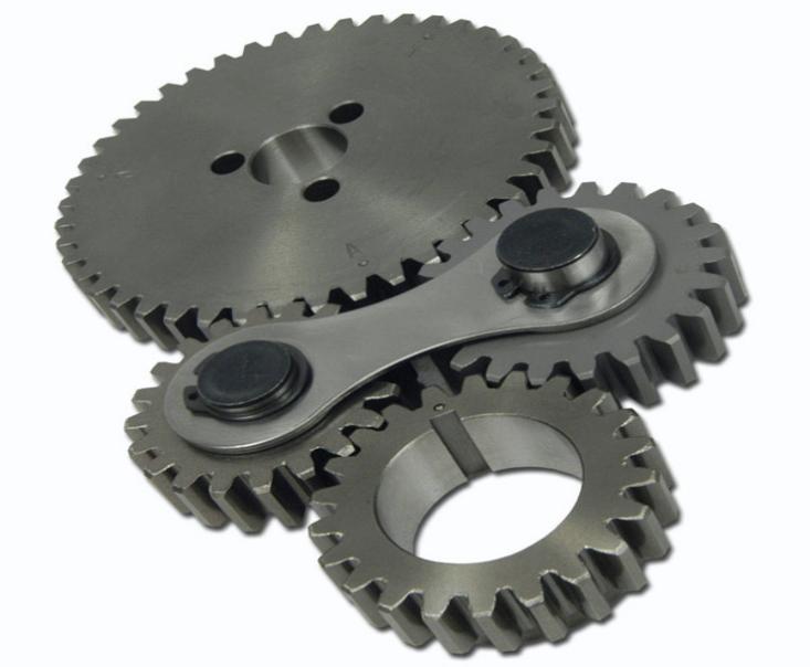

And if you want something to last forever in you Chevy motor then use one of these setups!!!
Also most of the problems with the belts is not the stretching it is the breaking/snapping, that is the reason for the tensioner to take up the slop! - Completely agree.

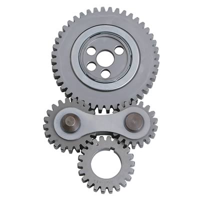

I keep these in stock for doing rebuilds on SBs...

Wanna know why we keep them in stock? We use them in race engines. Good try but you should OMIF now.

Timing chains will last forever and I stand behind that. We use the gears in motors that are turning excessive RPMs.
