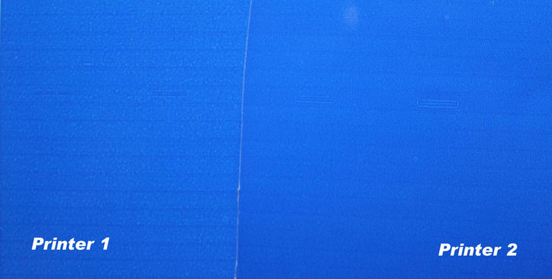

I decided to attach an image that directly represents the problem. The blue from printer #1 is not as crisp and clean as the blue from printer #2. I have this problem with printer #1 with pms 293 and similar or darker blues, greens, and reds that get close to browns or transition from deep red to brown.
So the question I'm posting regards to improving the print quality of printer #1 through printhead replacement is whether or not replacing the printhead on printer #1 will in fact return its print quality to something similar to printer #2?

If time is not an issue.. you can extend the life of #1 printer printheads by double the printing passes (16 passes? if possible). You will see the quality would match #2 printer..

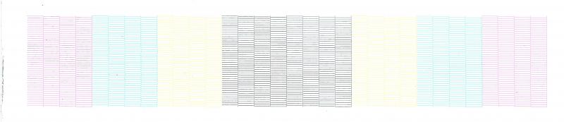

Well I tried a variety of things with no consistent results. However, I did find out that both printheads are well over 12 billion head shots so I'm resigned to the fact that neither printhead can be 'restored' to better quality. A local tech suggested that I re-profile both printers and dumb down the better quality printing printer to that of the printer with lesser quality. My abbreviation to this strategy was to remove the profiles from one rip station & replace them with copies from the other rip station. Comparative quality has improved but overall problem (blue color gamut print quality) remains.
I have attached a test print for further investigation & input.
Thanks for all your help!
