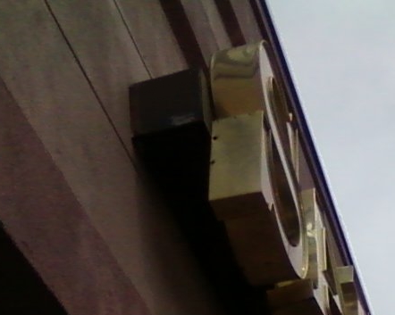

JAMEY
maybe the signmaker of the sign will post a photo...
Here is a quickie pic. I will get better pics of the backings when I go back. This was with my Samsung Rugby phone.
