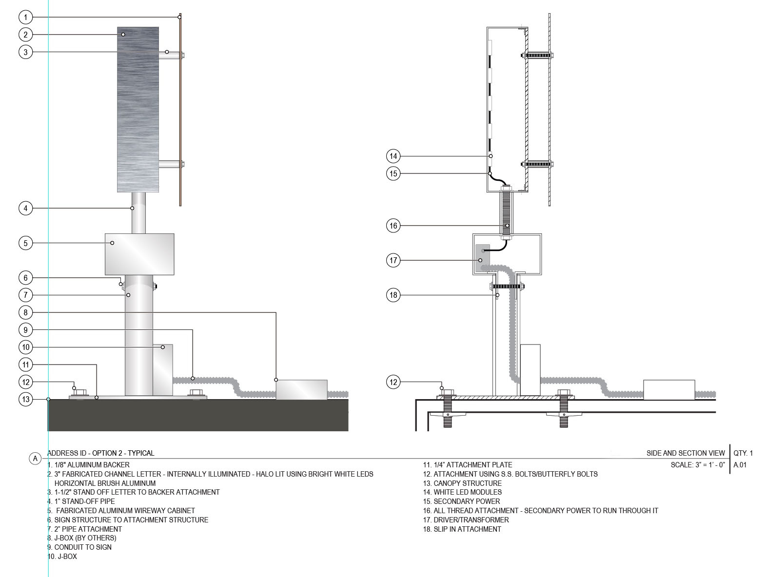

Most signs I design are one offs, it usually means a template may only give me a start... (see attached image)
I have learned more by observing and asking the shop guys how a sign is built or ask how they would build it and incorporate their ideas into the drawing, after a while, you will learn how signs are fabricated. When I worked at a shop, I used to go to the shop floor daily to see my designs get built, I would also go on installs and see how they are installed.
