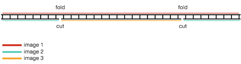

I'm probably not understanding, but this was my thought.

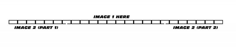

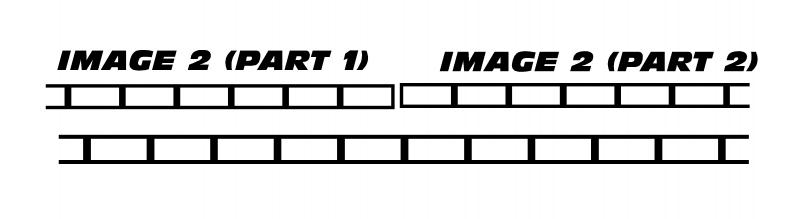

Couldn't you do it like this?
Cut where the slit is missing (notice image)
print the first image on the middle of the top side (notice 'image 1')
print the second image on two parts of the other side (notice 'image 2 part 1 & 2')
It seems pretty simple that this would be the best solution doesn't it?
Single piece of coro with two slits in it
