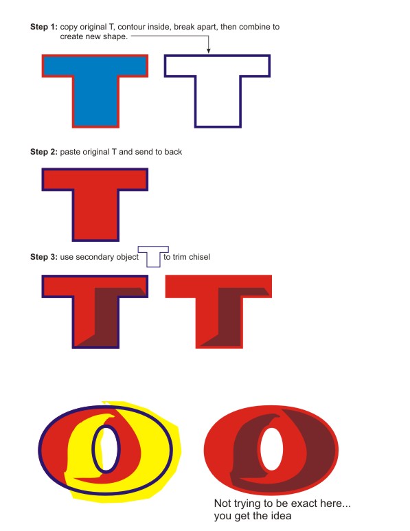

Shovelhead
For those that don't know how.....
:signs101:

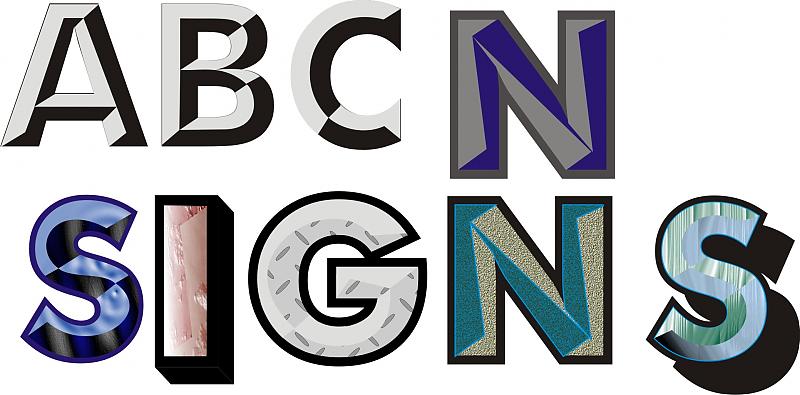

onesource
AS above by Shovel Head
No special tool , freehand tool, shape tool and trim tool
Created the paths where I wanted them and trimed then added to the duplicate letter. It's pretty quick to do, the rounded letters are a little slower to do but not much.
Here are a few I was messing with after finishing, you can open PhotoPaint and chisel for the lighting effect then draw the vector accordingly.
I have about 3 hours in the alphabet.
I put a little twist to the chisels with graphics, thought it was cool
