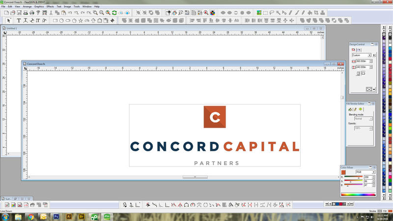

There is a Pantone Library. But it's not a swatch table at the bottom of your screen yet. If you make another swatch table and add the pantone library to it. All the pantone colors will appear on the bottom of your screen. So you could select object and just select color on the bottom to change it. I don't see how it can get easier then this. Never used anything but illustrator and flexi though. In my opinion I like flexis way better then illustrator.
Well you're nearly right...Simply right click any swatch table on your screen, click Open Table, select the Pantone Table of your choice and *boom* it's on your screen as a swatch. No need to create a swatch table then add anything. And it doesn't need to be on the bottom of the screen (see photo). I prefer mine lined up on the right. Left side pallette is Pantone, right side palette is all my custom colors for customers and everyday standard colors.
No offense, but once again, the issue is not obtaining and viewing Pantone tables or libraries, the issue is efficiently navigating through such (Corel does this with great ease and efficiency).

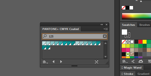

What version of Illustrator are ya'll using? You can search through Swatch Libraries in Illustrator by PMS number, it's pretty easy.
attachment.php
attachment.php
Well yes we all know that! He asked about F L E X I. Honestly does anyone read the post?
DerbyCitySignGuy
Yes, I read all of the posts in the thread located in the F L E X I forum. I was responding to the folks who commented that Illustrator was clumsy at choosing Pantones. No need to go all Bob on everybody.
