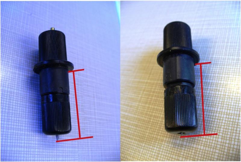

adjust the blade holder so that the knife blade sticks out farther.

are you saying do an actual tool height adjustment, like in section 4-17 of the manual, or the actual blade holder can be adjusted?
tiredcreations
Turning the black part on the blade holder (at the base) will move the blade in and out so it sticks out a bit further.
hmmm. thats what I thought. It is as tight as it can go & the blade is out at its furthest.
I don't really understand how this changes anything. The distance from the shoulder where the blade holder "sets" to the tip of the blade, stays the same
what am I missing?

What's the default setting for the blade holder? Threaded on half-way or so?
sfr table hockey
My blade is about 1/16" out. I am not sure of the material you are cutting. You could try doing 2 or 3 passes. It will cut a bit deeper each pass... Not sure on this one.
