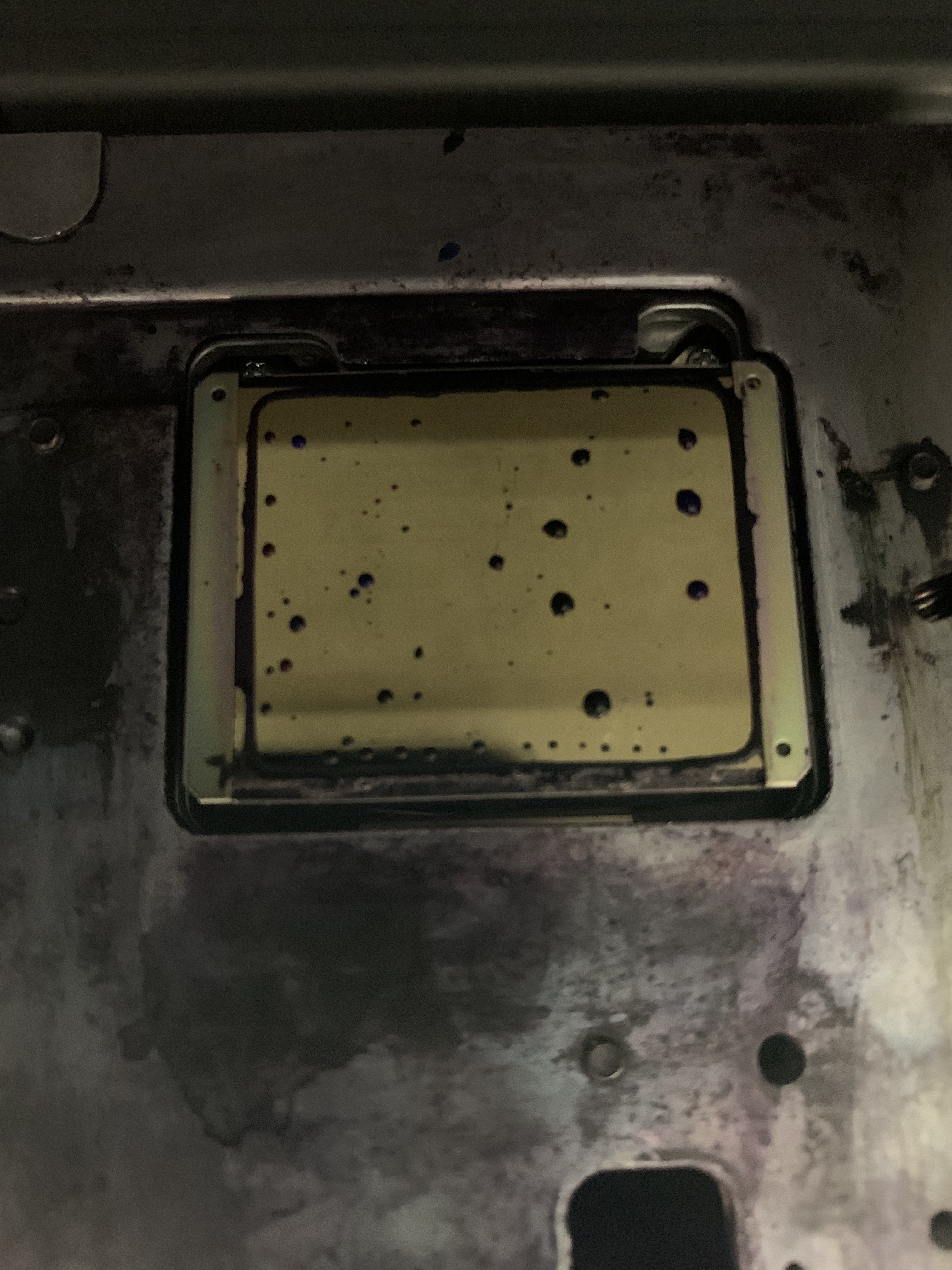

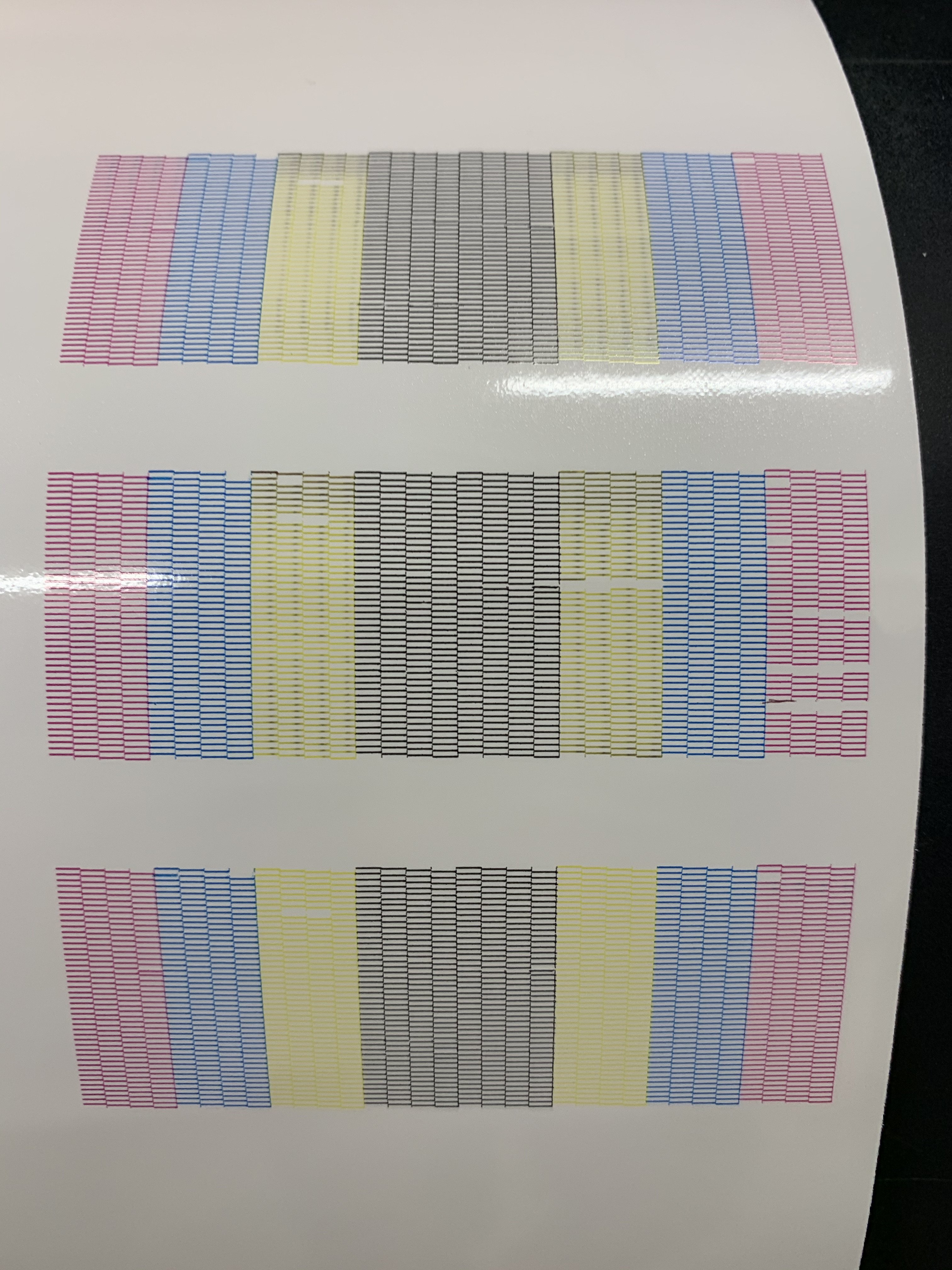

    So I'm having a strange issue that I think is due to the wiper not wiping the head. The bottom test print was the first test after the head was parked in the capping station. The middle test print is after a 1 min nozzle wash and the top test is after a second 1 minute nozzle wash immediately after the first one. I'm noticing during the nozzle washes that the wiper doesn't seem to be high enough and after the head goes across the wiper there is still ink on the bottom of the head. It's a brand new wiper, the old one did the same thing. Is there a way to adjust the wiper height?
