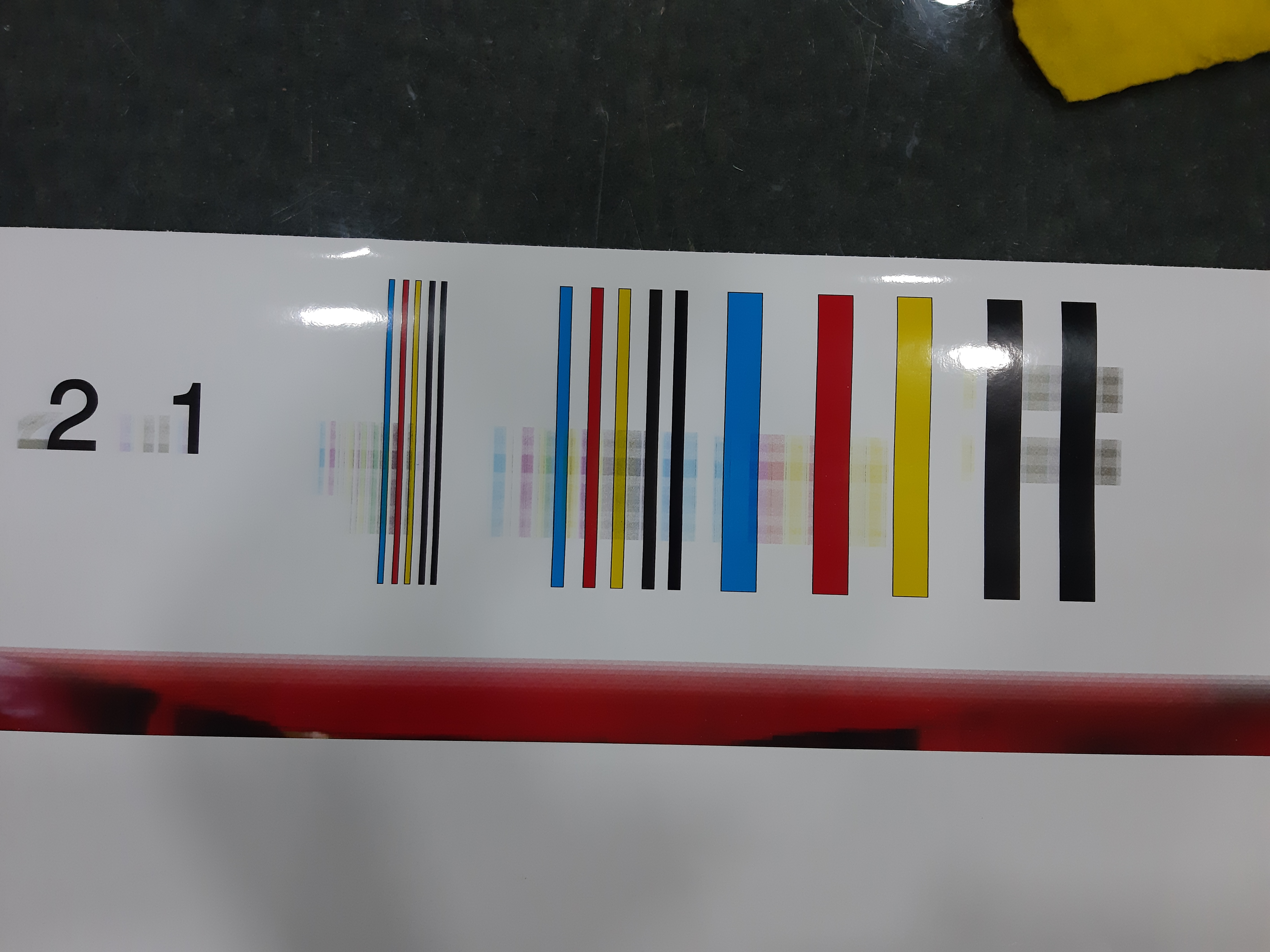

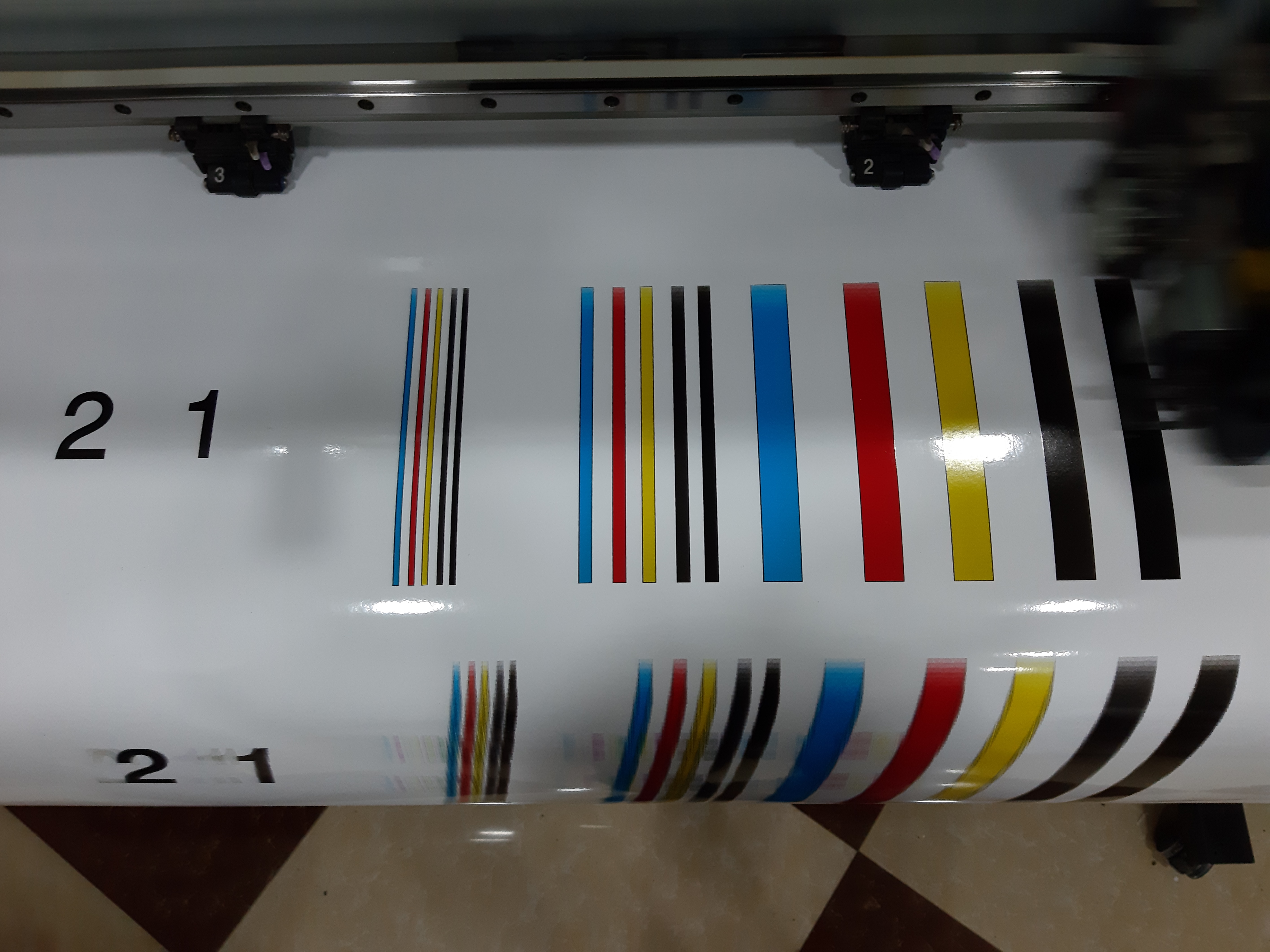

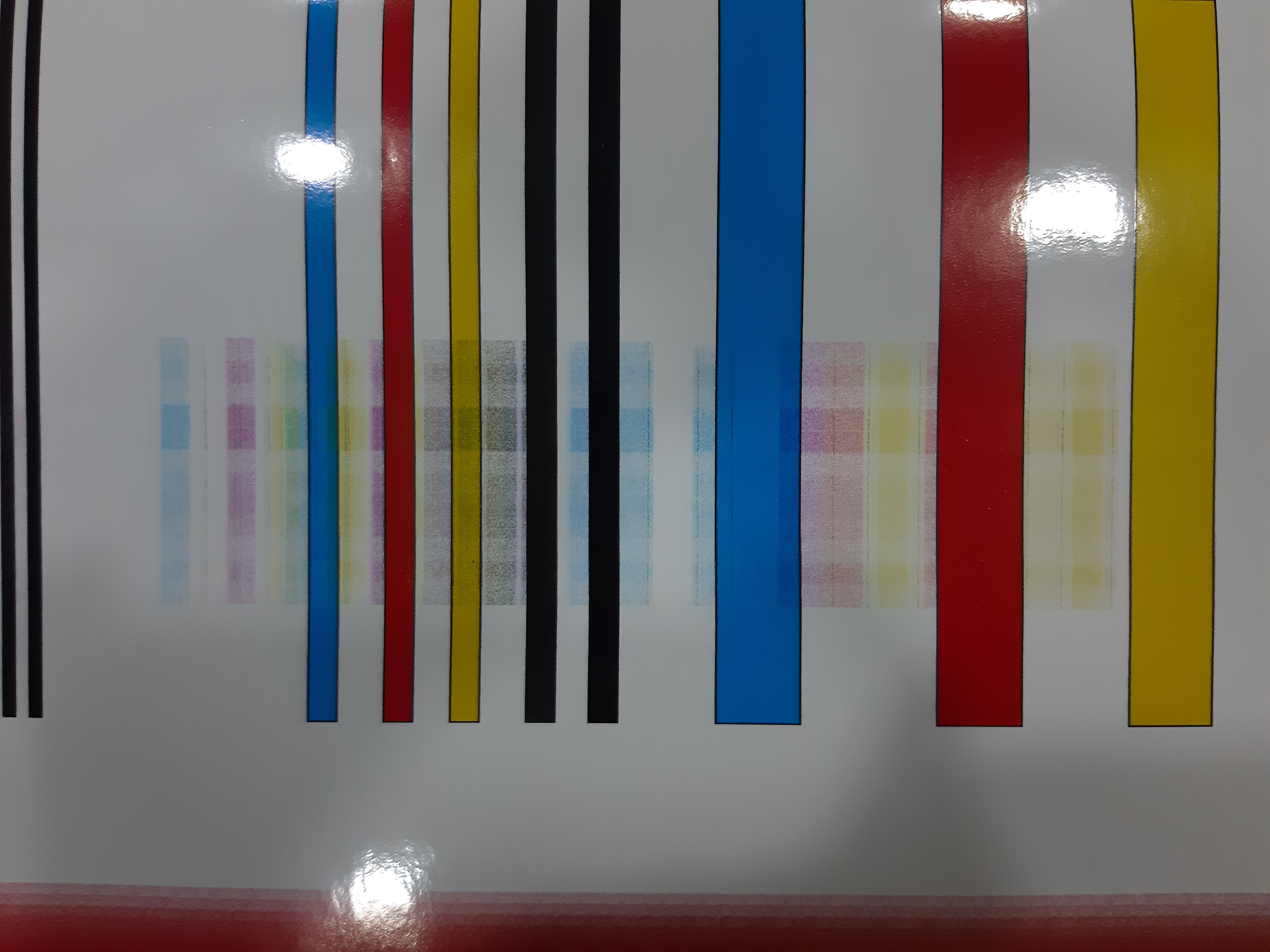

Hello, I have a CJV150-160, this morning I printed a file without problem, but after I had a problem, the printing starts perfectly and after 10 seconds it becomes blurred (photo attached). please help me solve this problem. Thank you

What problem happened exactly before this blurry issue? Maybe the head height was modified by accident. If that's the case, move it high and then low or vice versa, set the proper height then adjust DROP.POScorrect and FEED COMP (see detailed instructions on the user manual)

Thank you, I will try these steps and send you the result
