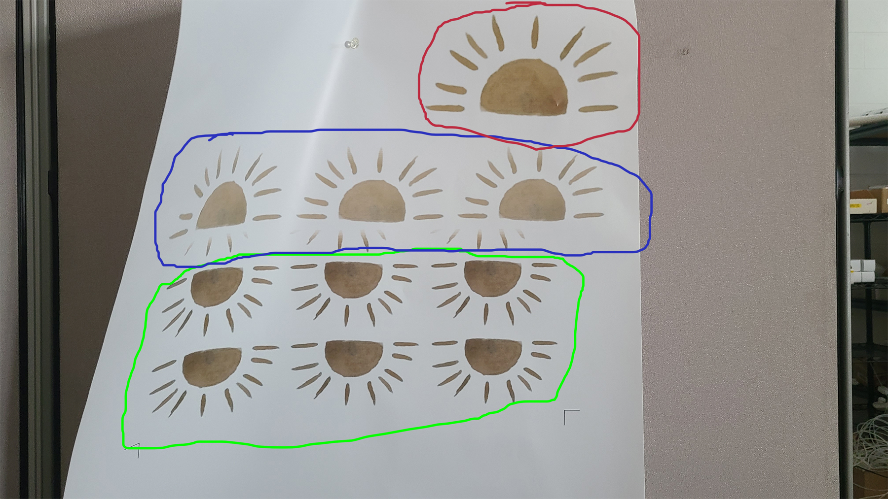

This might raise more questions than answers but see my print out below from a CJV150.
The print circled in green is your EPS file unedited and it looks a lot like your output. The print circled in blue is the original PDF from your customer, which had tons of clipping masks and weird file stuff going on btw. The print circled in red is what printed when I took a screenshot of the customer file and saved it as a TIFF. This leads me to a file issue of some sort but it's just weird that your Roland printer friend was able to print it correctly without changing anything. You might ask them if they did change anything.
This does indeed raise a lot more questions.
So.. I actually tried the same thing, and printed the EPS file, and then printed the PDF file (put directly into rasterlink) and there is NO difference. Both look very similar to the one that you have circled in green. What the actual F is going on here.
Can you advise on your settings in rasterlink and the file workflow, to see if I am missing something here?
I think th eone you have circled in blue is actually acceptable. Which profile are you running?
Are you sure you don't have any ink passing over to another line, creating some cross contamination ??
