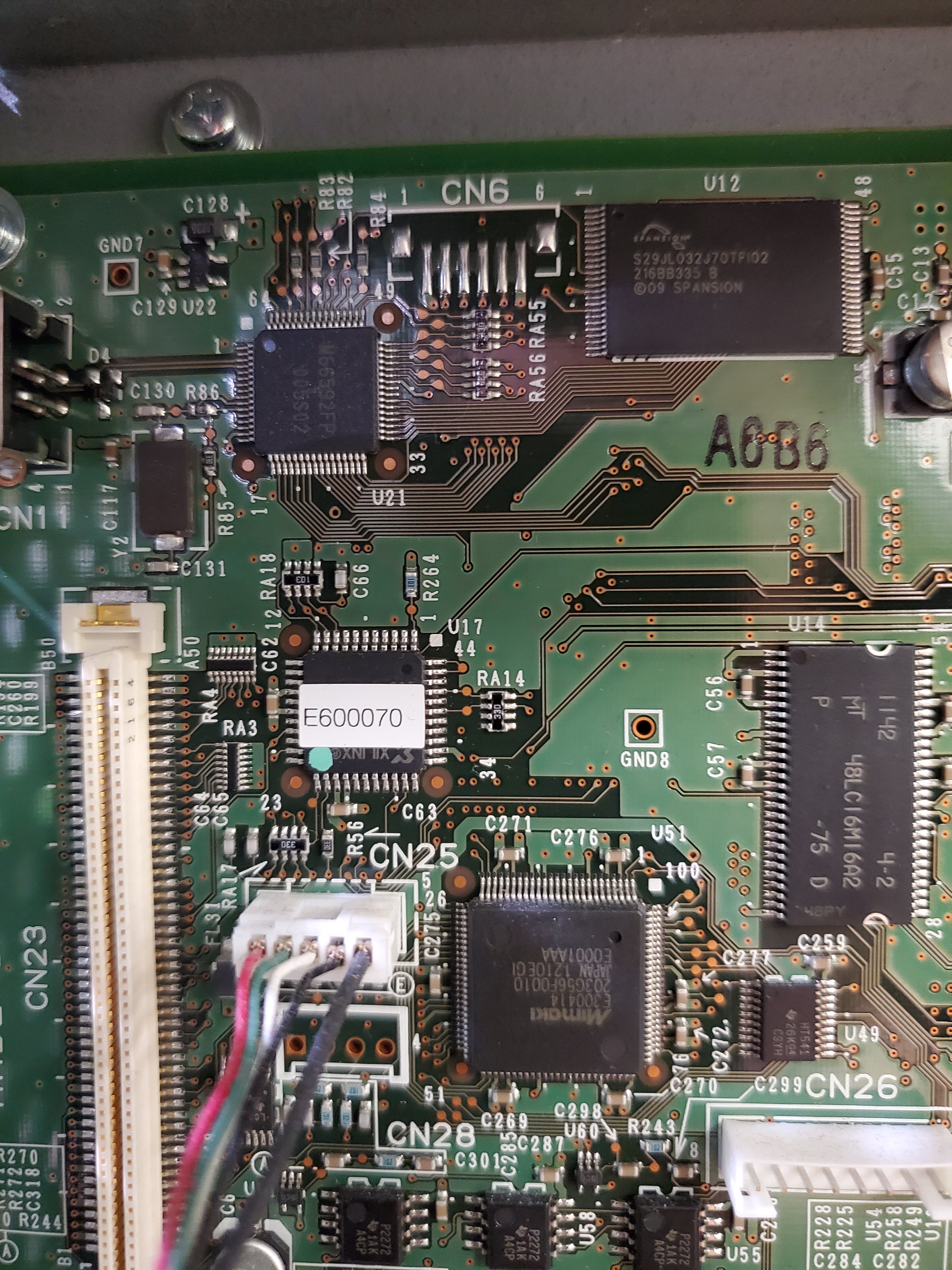

    I may be able to help you out. I have a surface mount rework station and do board repairs to a certain level. If you can send a hi-res pic of the mainboard, especially a pic in the USB connector area, I will see if I can identify the USB chip and if I can get one. Where on the east coast are you? I'm in Delray Beach. You can call the number in my signature if you want to discuss on the phone.

    The USB port itself is the top left corner of the picture. Let me know what ya think. We are in Merritt Island, FL. Looks like 2.5 hours from you.

    I can get the chip. Please call me to discuss.
