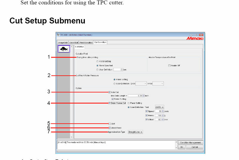

I have noticed that my software does not use the most efficient cutting patterns. I am printing several thousands rectangular boxes. It will do a line here, Then jump to a completely different side of the machine and do a line in a completely different decal. Then hop back to the first on do a line then back and forth etc... It is completely in inefficient. How can I " re-map) or dictate how the machine cuts ?

Not familiar with the printer/cutter or Rasterlink but a quick google search shows that v5 does have a sort function.
Option #5 (hard to see in the screen cap)
Not much info on it other than to turn it on or off.
I use a Graphtec cutter that has a sort option that can be turned on and off at the cutter keypad.

Thanks Wayne! I have been using the sort option. But whatever you do in the creation state of the art, Will inevitably dictate what the sort function can do it seems. So I chose to make a compound path and it seems to do a much better job on the preview of how the machine views the art to cut.. If I find a more efficient way, I will relay it back to everyone. Thanks!
SightLine
I think most cutting software when dealing with multiple object to cut in the same artwork file use the layers stack order of the objects.
