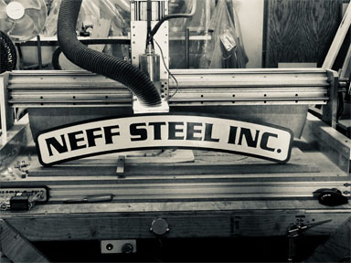

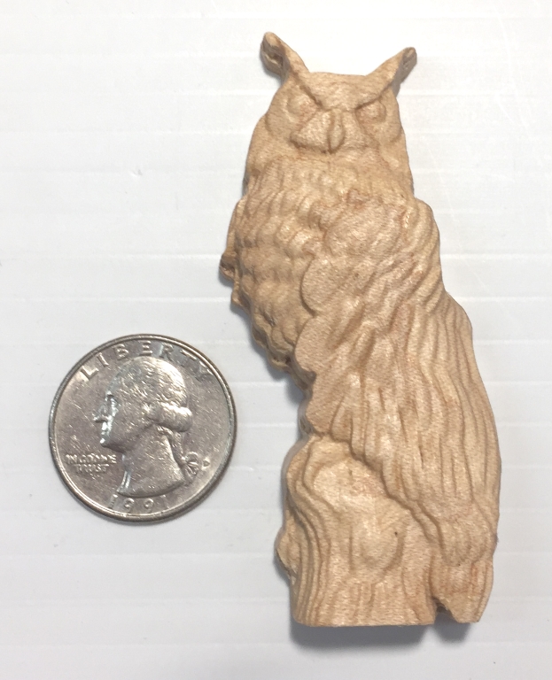

I went with a 4X4 diy cnc and love it.
Can do nice size signs and smaller things.
mark-s
