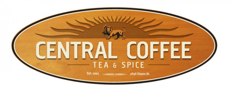

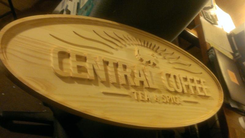

Anyone got any experience or thoughts on working with this wood type for a CNC-routed sign?
I attached a mock-up for the design plus a prototype we routed out of pine.
We're basically looking for a nice, durable wood for routing / staining. Joe Crumley and a few others (thanks all!) suggested Cedar might best but the samples we got were a bit lacking in visible grain. My client is wanting to go for mahogany for some reason but I'm concerned about price/ durability. Also what's the deal with choosing wood that's vertical grain rather than horizontal? I know next to nothing about this.

If price is a concern then Mahogany is a problem. There are various types of Mahogany with some (phillipine) not actually Mahogany at all. Honduras is the best bet but will vary in grain so put eyeballs on it if possible. Its hard to get as well. Find a local exotic hardwood place and ask them what your options are.
It routes beautiful and is very durable, we have routed some big (3' x 10') boat panels from it with Sikkens - awesome.
Small intricate areas can be a problem with any wood due to the grain as they may pop off so careful tooling is important.
