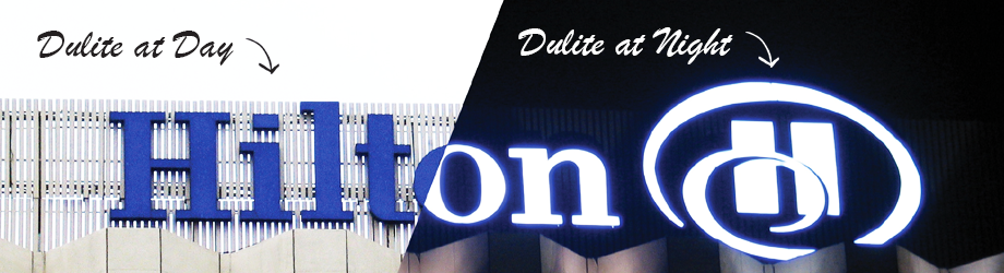

    printed day night vinyl

    Thanks all! Was hoping to avoid the perferated vinyl route. Love the Dulite - but that is an acrylic and not the right color blue - looks great for black and white. Landlord won't go for the halo. Going with 3M 3625 210 dual blockout film series. Again, thanks, I appreciate the people on this forum!
