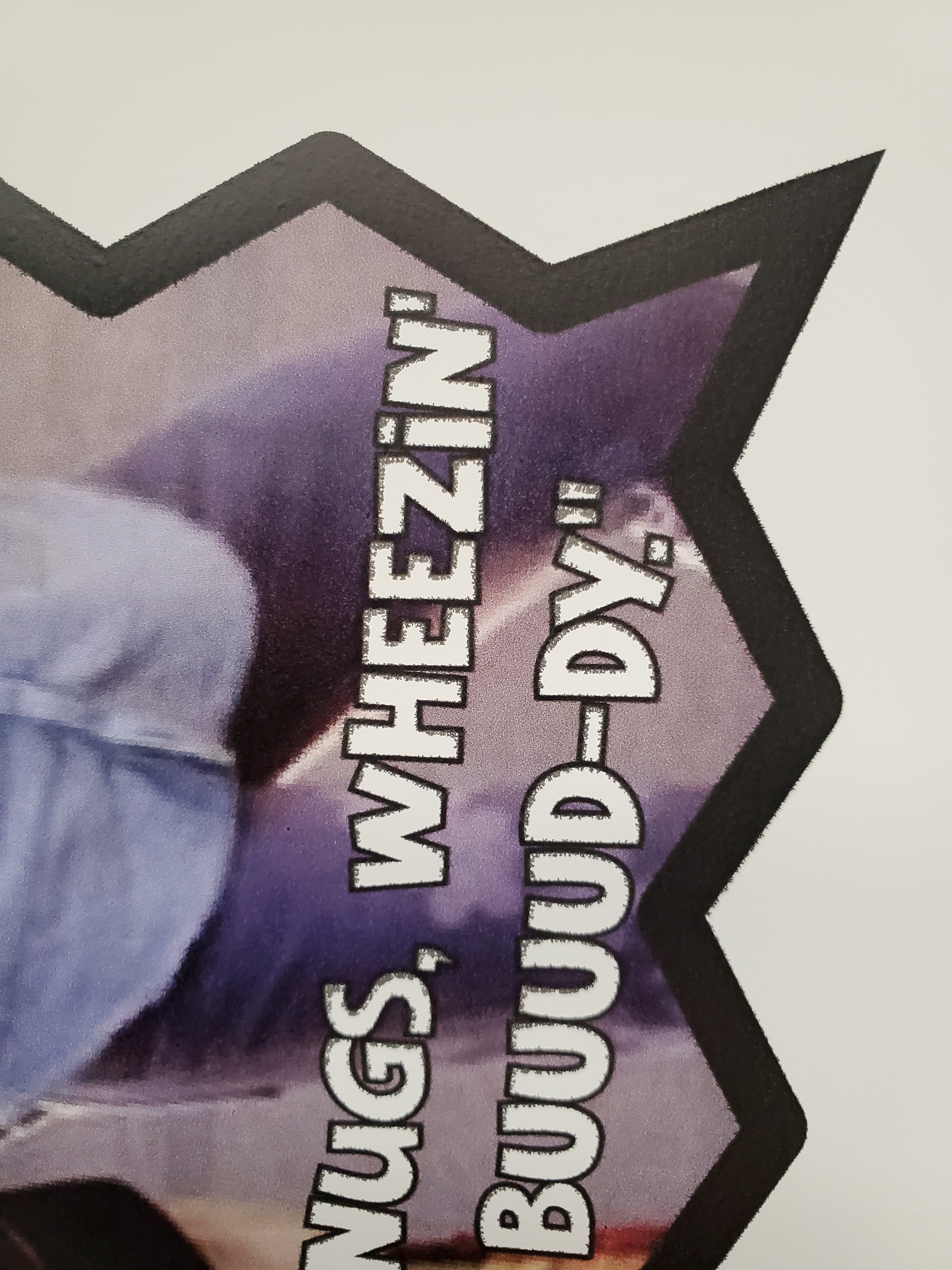

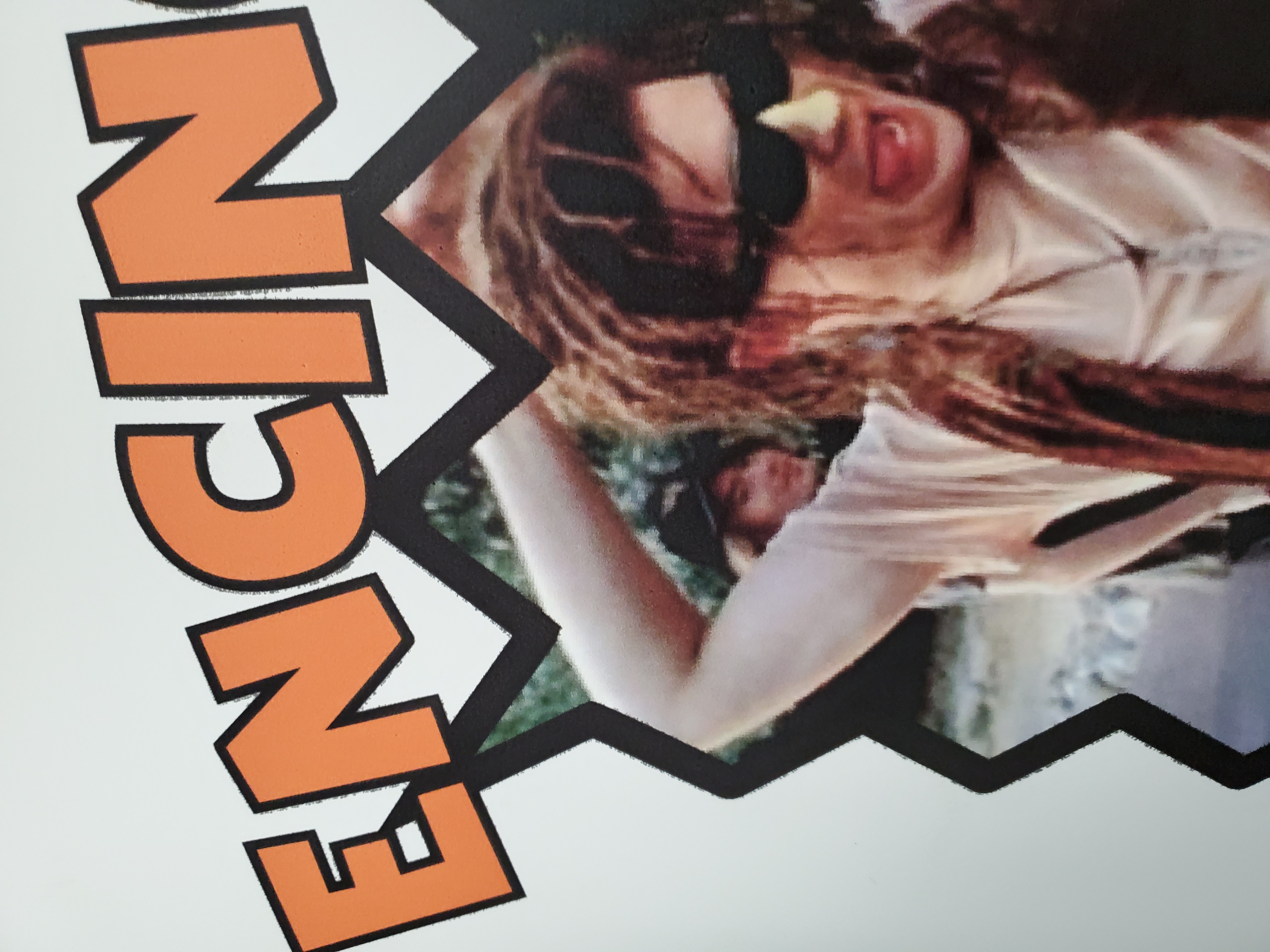

Ok, so I had print issues thinking that it was printheads and optimizers. ALL of those have been replaced and everything prints nicely EXCEPT ON my heat transfer vinyl. For some reason the black is fuzzy. like it's dropping too much ink. I have selected another color profile and changed the number of passes. But when I did that, suddenly blue on a facebook logo is now gray. So I downloaded a new color profile and get the colors more vibrant but I still have a fuzziness issue with the black. It's LESS, but still not perfect lines. WHAT do I DO? I've spent all day with this issue. I am using digicat turbo by GSG and using a siser profile. I've done this for a year now and no issues. BUT now all of the sudden I have issues with it.

not hot in the print room. I've used this same heat transfer vinyl for a year now with the same profile and it printed beautifully before. Now that I have changed printheads it's all funky. It's like it's dropping too much black. but I don't know how to correct that.

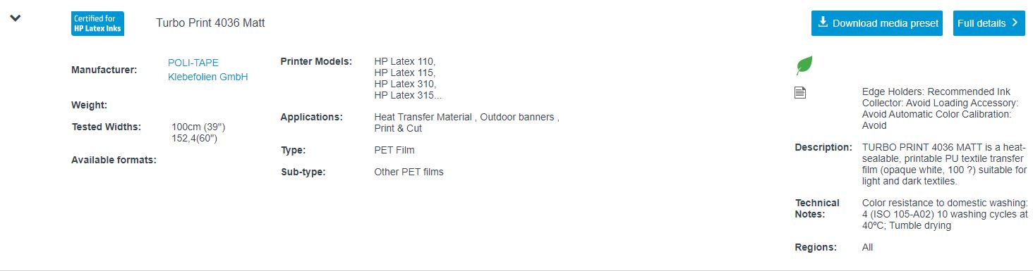

I would suggest pulling down and installing the Media Preset for Poli-Tape Turbo Print 4036 from the HP Media Locator.
https://www.printos.com/ml/#/medialocator
Search (icon of a blue filter) under manufacturer = Poli-Tape, and download the OMS file for the 315 printer, and install it through the Embedded Web Server interface.
It is a Certified media preset.

The number of passes seems to be what makes the difference. the more passes of ink it drops, the more distorted the black becomes.
